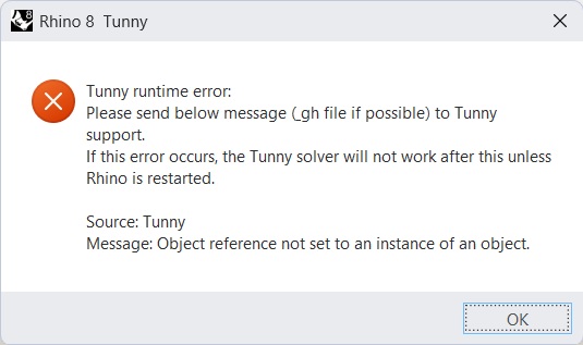

I’m trying to use Tunny with my Grasshopper definition, but I’ve run into an issue and would appreciate your help.
I followed the steps outlined in the documentation:
  1. Downloaded the latest version (v1.0.6-RC.2)
  2. Dragged the appropriate version for Rhino 8 into Rhino
  3. Double-clicked the Tunny component to install the required libraries
I confirmed that the .tunny_env folder was created. However, when I press the Run button, nothing happens—even after waiting several minutes. When I press Stop, I receive an error (attached).

Hi @pooyan_k,
Three possibilities can be considered:
  1. What is the status of the Python folder in .tunny_env? There may have been a failure in installing the Python files necessary for optimization.
  2. Is Wallacei installed? Depending on the environment, it seems that sometimes it doesn’t work properly when Wallacei is installed.
  3. Which sampler are you using? Since some samplers may fail to execute, could you please check if you get the same results with the TPE sampler?

I believe the first possibility you mentioned is more likely. My Grasshopper definition includes several GhPython components, and when I open the file with the Tunny component added, I encounter errors related to all GhPython components. However, if I remove Tunny and reopen the definition, these errors no longer appear.
Additionally, when using Tunny, the optimization process takes 5–10 minutes to start and runs very slowly (with TPE). In contrast, the same definition runs much faster with Opossum, and even with Tunny 0.10, the performance was significantly better. Moreover, I’m unable to stop the optimization without force-quitting Rhino via Task Manager.
I’m also wondering if Tunny might conflict with other plugins, such as Speckle. I’ve attached a screenshot showing an error from the Speckle Receive component, which might indicate a conflict between Tunny’s Python environment and other software—or possibly an issue with missing or improperly installed packages.

About Images
It seems that the sqlite library used by Tunny is conflicting with other plugins. This problem also occurs with another plugin and will be fixed in the next version.
