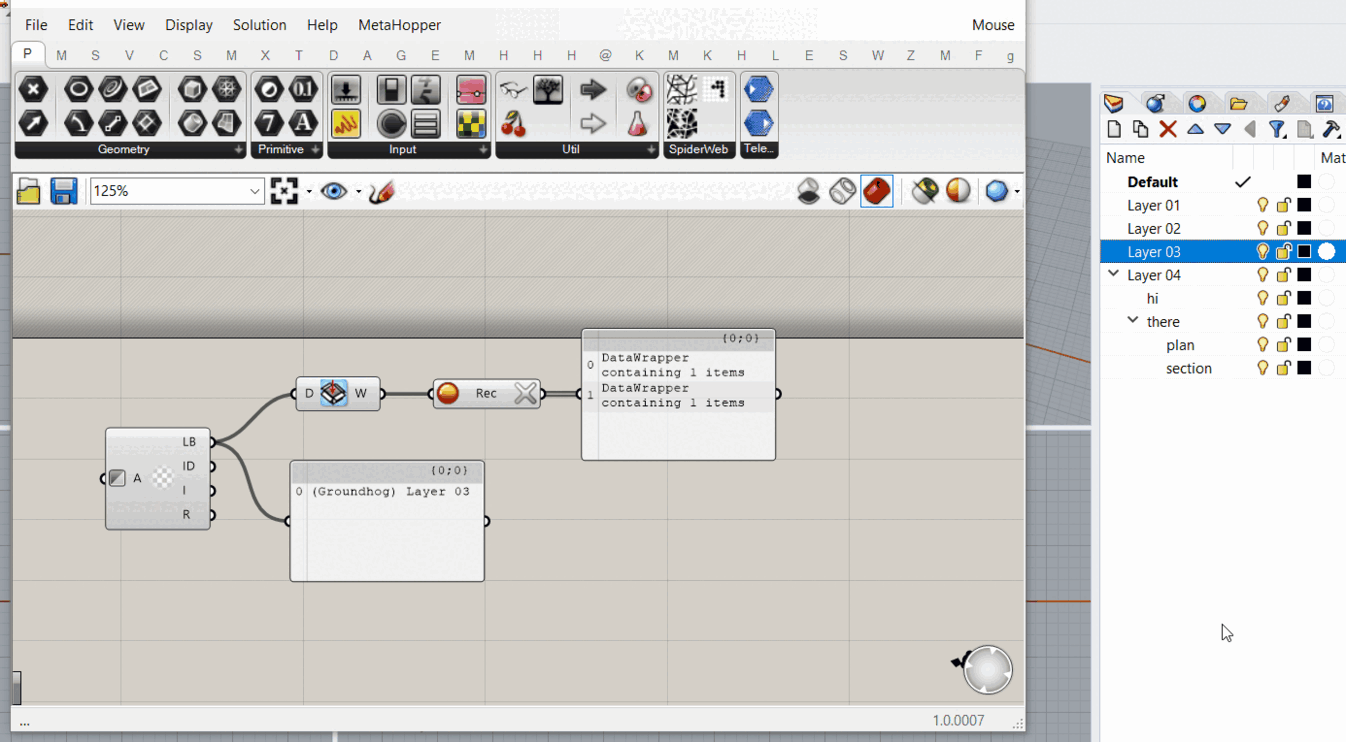

Well… so… it works. But I can’t say I don’t feel dirty. (I did get some unholy crashes, @andheum should know.)
OS-level mouse hook + LayerTable.GetSelected()

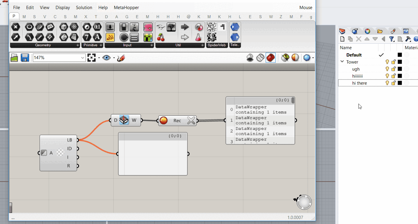

So… just an update, since I worked through the crashes for solving various event cases.
The component uses an unholy matrimony of OS-level Mouse Hook, OS-level key listener, and custom debouncer to avoid using ScheduleSolution (which crashes Rhino).
Had to put a delay on my events because layer deselect happens on mouseup, meaning a mouseup listener doesn’t catch the changed layerstate. ScheduleSolution results in a StackOverflow hard crash, but luckily I solved this problem for layer listening a while back so I just implemented the custom debouncer. You’ll notice that the key listener is used because changing a layer name in the layer panel doesn’t catch the new state (because there’s no mouse click).
I throttle the ExpireSolution in the event handler using a cache so that the component doesn’t fire on every mouse and keypress, only when the selected layers have changed.
All that said, I’m slightly terrified to use this component in a deployed product, I have this sneaking anxiety that using it in a large definition with all my other listeners active is likely to blow up Rhino/GH. :slight_smile: I’ll save it for emergency usage only until I can prove it in the wild.
