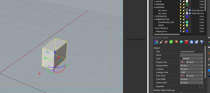

When i’m trying to change an object’s layer from the properties panel, it requieres to hold the mouse click now. Is this a new change or my mouse is broken? I tried this with my laptop pad and it works the same.
In the Properties panel I just need to click on the current layer name, move the cursor to highlight the desired layer and left click on the highlighted layer.

In the properties panel, if i go to change the layer of the object selected, i have to click and hold to navigate this list of layers and then let go when I find the layer i want to assign. If I don’t do that, rhino just choose the layer in which my cursor is standing.

if you click an object then go into properties to change the layer, you have to click and hold.
Usually you can click once and the menu stays open

I’m having real problems with changing an objects layer using the properties panel, its definitely buggy, if you have sub layers its almost impossible
So, I’ve found that it happens when I have enough layers that the drop box that opens exceeds my window space. So if I remove layers it works again. Or if I put the tool in a spot that allows the dropbox room within the window.
It seems like its just when there’s no room for the dropbox - it becomes a click and hold situation. Maybe this is all by design and I’m an idiot…
Im now keeping properties panel on my upper right side instead of my lower right side.

It looks like this issue was fixed a few hours ago. This fix went into 8.x - which currently is 8.22.
This should become available as a public release on Tuesday next week if all goes well.
RH-88003 Properties Layer dropdown loses focus when resized
RH-88003 is fixed in Rhino 8 Service Release 22
