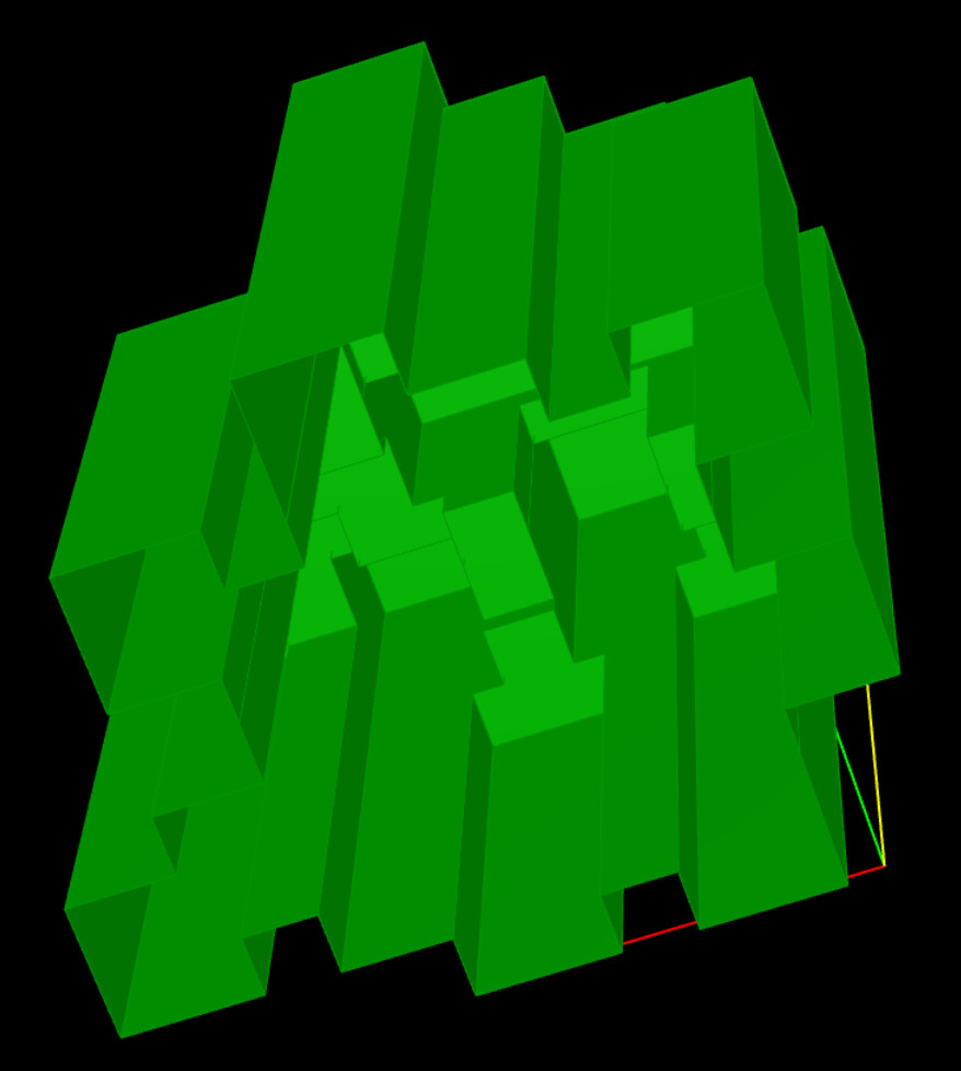

I have a group of conjoined boxes that looks like this:
I removed the bottom surfaces of all the boxes to make an open shell like this:
My intent is to put a light inside so it can show out through holes (windows) in the outside shell. To test this I made a rectangular solid cutter that makes a window on opposite sides:
So I made a big collection of cutters like this:
Then I did an SDiff and got this:
Not bad for a first try - but the bottom looks like this:
Oops! It looks like SDiff returned the original bottom surface before it did the subtraction. My guess is that’s because it uses the original Closed Brep version of the shell, even though it’s input was not that. The bottom surface makes it impossible to put a light inside the shell, so I’m stuck,

Alignment of your ā€˜Cutters’ with your ā€˜Shell’ is poor. Why use SDiff when your ā€˜Shell’ is an ā€œOpen Brepā€ :question: (not ā€œsolidā€)
But SDiff appears to work if you separate the X and Y cutters and do them one after the other. Still, I can think of multiple ways to do this…
Leopold: that’s close, but still not quite right. There are lots of missing parts/walls.
Joseph: Aha! Thanks. I’ll try the one group of cutters at a time. (But I wonder why this will work differently from the 2 combined.)
I’ll do some experiments with Trim also - not tried that one before.
23.3 minutes. Utterly ridiculous :bangbang: You are far from new at this @Birk_Binnard, so you should know better.

Very nice :bangbang: Looks very close to perfect to me. Well done. :+1:
That looks good to me - certainly better than anything I’ve been able to come up with using SDiff or Trim. (I need to understand what the difference is between those 2.) The problem I have with your method is it is so unintuitive - at least for me. It’s going to take me a while to figure out why it works as well as it does.
My method basically involves cutting out individual faces rather than the entire brep.

OK, I’m I’m not afraid to admit that your method is far superior to mine, and more importantly, that mine will probably never work the way I intended.
I generated the boxes from a set of random sizes because I thought I could configure the size and placement of the cutouts to fit simply by tweaking their parameters. After trying that for a while I’m thinking that is just not going to work, basically because there is no ā€œone size fits allā€ set of cutout parameters that will work.
Your solution completely solves this problem, including the one about extruding the tops:
Using your method this was surprisingly easy to do:
So it looks like I’ll be working with the individual boxes like you did. Thanks again for saving me from myself. :grinning:
