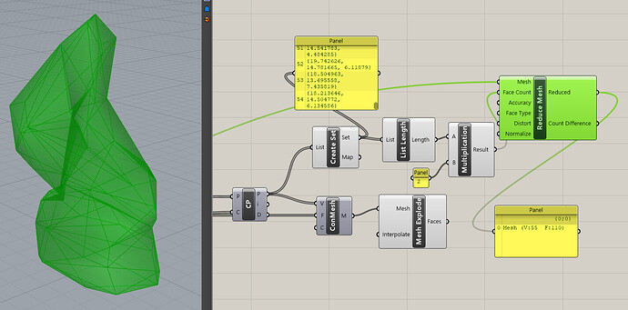

I have created a low poly mesh with the script and unfortunately I get an invalid mesh which I cannot use for further processing.
Can someone help me how to fix this problem?

Hi Luca, You can get details of the error with Null Item component
Thanks. Do you know how I can solve this problem ?
I think there might be other paths available such as Shrinkwrap, TriRemesh, QuadRemesh that might suffice.
Hopefully some mesh aficionados can chime in as well.
or you can try reduce mesh. in your previous script, the closest point outputs 55 unique vertices. (you can test that by passing it into a set, which removes duplicate]
so that’s 110 faces by eulers formula for triangle meshes (f = 2v)
so you can use that to remesh your original mesh
Low_Poly_McNeel Edited v0.gh (215.9 KB)
if (!Mcheck.IsValid)
  Mesh result = Mcheck.DuplicateMesh();
  Mcheck.Vertices.CombineIdentical(true, true);
  Mcheck.Faces.CullDegenerateFaces();
  Mcheck.Vertices.CullUnused();
  Mcheck.RebuildNormals();
M = Mcheck;
