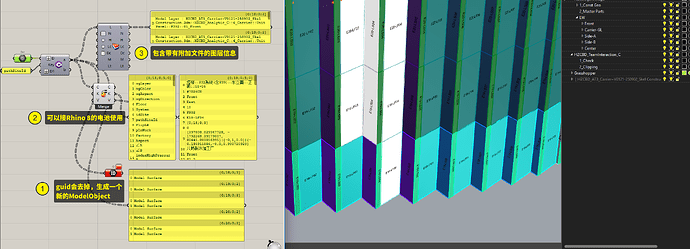

In a large project in Architectural Facade, model size normally are too big, and we will use seperate files instead of all-in-one.
In the construction stage, the import omponent in my fixing mature workflow acts a significant role, this is great.
But in some reasons, you just want to check the old version file with the new one, so attaching the older file and other relevant 3dms, then visually mannually check the attributes of the geometry, and maybe you need to regress the portion of the atrributes by the older one. What’s the most efficient way is to quickly select multiple objects (they could be in different layers) and reference to gh to go with specific programs. However, if I use import component, I have to go with the following steps:
1, drag components out and place
2, copy the file path of the target files, maybe multiple files, so multiple times
3, click import
4, drag multiple match and filter components
5, check the objects’ specific features
6, filter the objects ……(multiple times to select exactly what you want)
Comparing to the old way of elefront referenced objects’ steps:
2, reference objects you want
These two way have their own advantages. I expect the reference-object way should be supported officially.
May be a simple way that duplicates a modelobject with the attributes of the referenced object and omit the guid is enough for me.

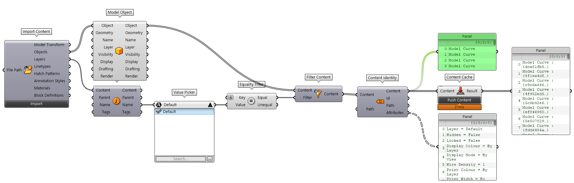

Just as a start, if import Content is used to grab the outside file. This does not come with Guids. Then the can be Cached into the file if wanted or compared with attributes in Grasshopper to the objects with in the file.
Here is the import, filter and find attributes part. Essentially it is a reference in itself.
While it is not always necessary to Cache the objects by grabbing the result of the cache, the objects and the new Guiids can be used later in the process.

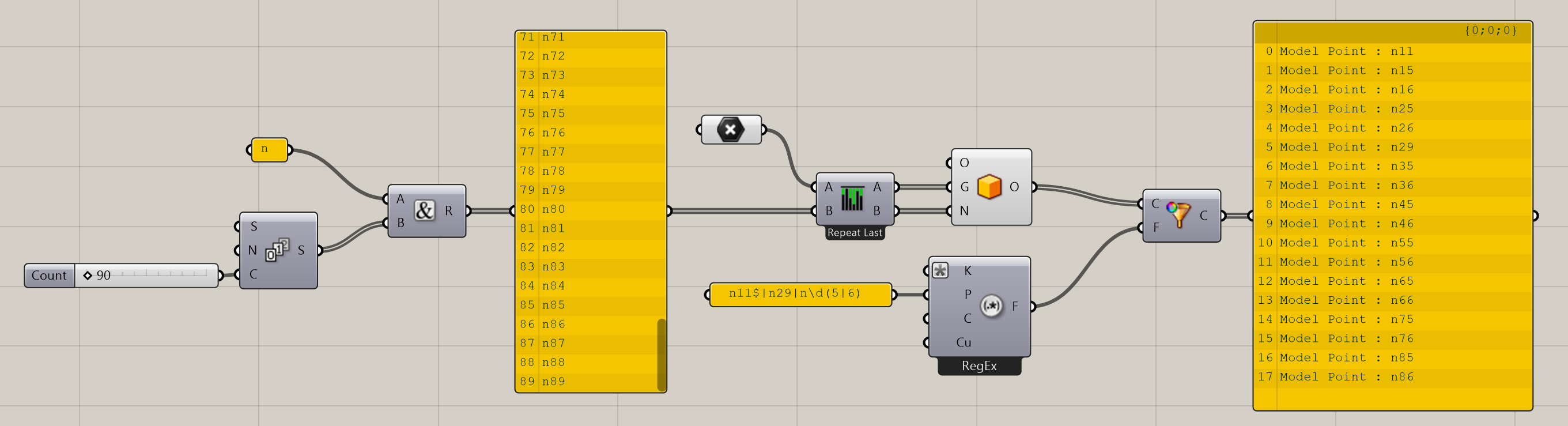

If I needed to extract ‘n11’, n’29’ or 'n??’ with two digits that end with 5 or 6 just as a random example… I’d use regex filters
regex_model_object.gh (14.7 KB)
I don’t like to rely on filtering indices since a dataset can change and you end up having a mess with shifted lists and what not. A regex filter in a panel does not automatically update.

If Window select is a critical important part of the process. Then import and run the Cache to get those objects in the viewport and selectable. Then select run the analysis in Grasshopper off a Model Object Param. Of course then the selection can be changed at anytime using Window selects.
When imported objects using can be Cached using a CacheName in the to specify an identifier. That CacheName can also be used to effect the Layers the object land on if it is important the duplicate objects are on different layers. Details on CacheName can be found here: Content Cache Updated Guide
