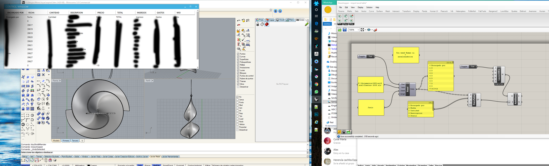

import excel table.gh (11.6 KB)
enhanced version
you get a window with the sheets in your file
