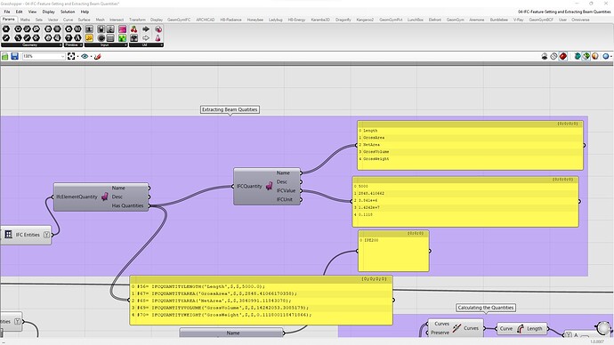

So as far as I understood it is not possible to extract quantities like volume after an IFC element is created, right?!
I mean to have something like this screenshot:
The ggIFC plugin doesn’t automatically calculate quantities.
But you can get the geometry and determine them from that, and assign them into the resultant IFC to export.
