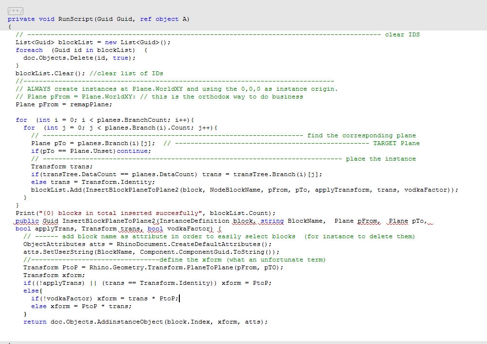

OK, I’ll provide a full C# demo on that matter soon (i.e. get the List of instances available, pick one by index and then having a bunch of trans on hand … do whatever you want).
In the mean time:
  1. Instance definitions are “static” in the sence that you can’t modify them (for good reason: they are just the cookie cutters for the cookies). Imagine having lot’s of nested (as in real-life) instance defs … and doing havoc on them that way. If on the other hand you want to create a variant of a given instance def (or vary the anchor point etc etc) … well … that’s another animal (notify if you need to include that to the demo).
  2. If you want to apply a trans on an instance def … then you do it at placement time (in the Active Doc: that does the doc.Objects.AddinstanceObject(…)). This means that the objects placed (the cookies from the cookie cutter) are added (as Baris observed) to the R file and no baking - obviously - is required. So we have cookies that are identical with regard the data structure with the donor cookie … plus a transformation (per placed cookie) that varies the “look” of it.

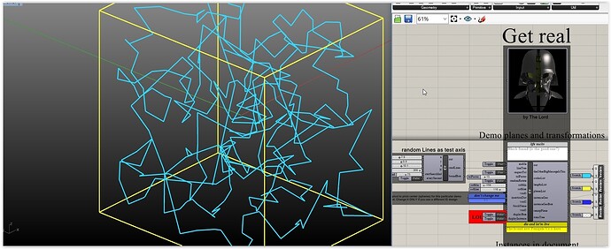

Instances_place_12_V1.gh (133.5 KB)
Instances_place_12_V1.3dm (1.5 MB)
This is one of my (about 50) defs used to measure GPU performance: how fast can R place 1K Instances? (CPU is not an issue - for the likes of I7, I9, Ryzen etc etc).
So the 2 top most C#'s create a random collection of axis and the transformations required for placing AND transforming the instance in question. Since these axis are “linear” the demo instances used are “linear” as well.
The middle C# reports what instances are available and allows you to pick one (Note: on purpose 2 out of 3 have wrong orientation: the most important thingy in assembly/component modeling is the right orientation/pivot etc etc).
The last does the job: For using your data you must provide a matching collection (tree) of planes and transformations (and obviously an ID name).

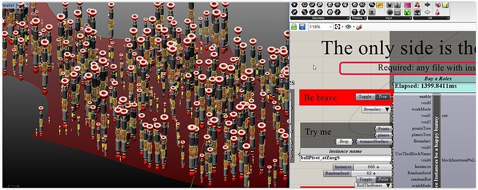

Instances_place_GPUCPUtests_35_V1.gh (156.8 KB)
This works in 3 modes (workMode var):
  1. Either provide valid (not Point3d.Unset) points and instances are placed there
  2. Or provide valid planes (that does the first C# as a demo). DO NOT use the big mesh if you are not a big spender on firmware: Reason is that Rhino does the placement of 5K things very fast … but the big question is: can your GPU cut the mustard (in Rendered viewport mode) properly ??? (We live once: hit the bank and go for SLI NVidia Kepler Quadros 4/5/6)
  3. Or provide a valid BrepFace and things (for count: use Instances ) are placed randomly .
You can control what sort of trans is used for the placement (rotation, scale etc). Test it with some happy bunnies ID (as meshes) or use a proper T-Rex heavy ID mesh (only for the very brave).
NOTE: After placement if you want to delete’m all just disable the last C#. If you don’t do that … well … any change that happens in any slider anywhere … yields more instances in the Active document (the same or different). Anyway … If for any reason you have multiple placements you should pick a loaded one by index and then disable the C# (that deletes all the instances present with the same name). Of course you can delete’m the manual way.
