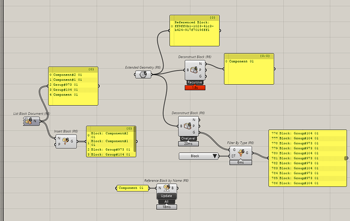

Elefront has some block components. See below for a Elefront 4.3 example.
Rhino WIP has some new block features in GH1 as well.
RE_block_components.gh (11.4 KB)

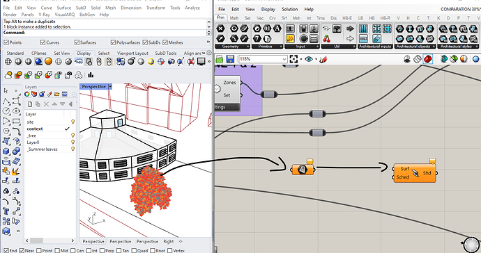

this is what i need to do

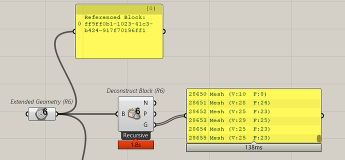

The tree contains over 28,000 meshes, which can be extracted using the Deconstruct Block. This takes a few seconds and be aware that any further actions (converting to a surface?) are going to be intensive. What is the goal here?
the goal is to simulate shading effect in a building
