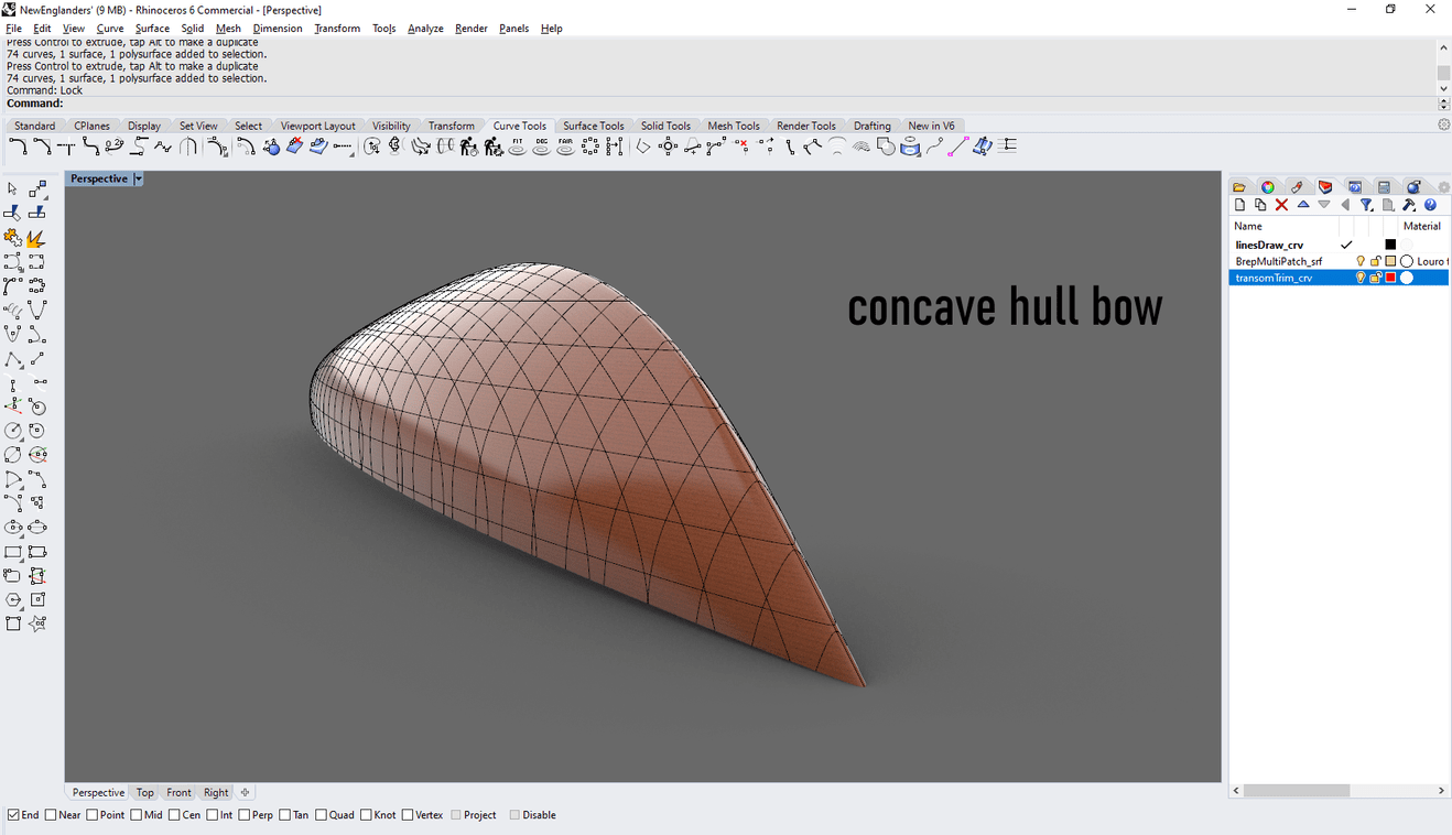

howdy, folks! I’ve been modeling a sailYacht since last week. I need professional assistance for hull fairing…
The surface of the hull is a Brep multiPatch. Each surface patch was originally built in third order, mathematically smoothest degree possible… but later on, it was increased to fourth order improve the tangency between srf patches for better looking zebras. the control net was doubled for better control over convex areas of the hull. partially below the waterline. is there anything i can do to fair these patches… some people suggest having the hull built in a single surface, but thats not recommended because in that process a lot of information and mathematical properties are lost… check out my hull please…

I use custom methods to generate hulls parametrically. I have different methods for different hull types and fabrications methods. Specific properties are controlled by parameters. By calculating the surfaces mathematically it is possible to use simple and clean NURBS topology which one cannot create or edit manually. Or well, it is possible to edit by hand but it is way too cumbersome, time consuming and the results are rarely perfect.
Do you mean your “comparison between quadratic vs. cubic”?
What I see is a curve with continuous changing curvature which has been rationalized with the _Convert command to arc segments. These arcs have constant curvature, therefore you see the steps in the curvature graph. Of course the original curve is smoother (if this was your question).
You do not have to worry about that kind of segmentation if it is introduced by the fabrication process for example for laser-cutting stringers or by milling a mold for fiberglas. Of course that’s a different story if you want to fabricate your hull from wooden planks or sheet material with certain properties.
How do you want to build that boat?

That looks nice and smooth already. I assume it is a classic wooden hull? I’m not so sure about the stability for a sailing boat though. What kind of keel you have in mind? Any other specs? Can you post the hydrostatics? What are the skills you want to impress with?

While not specifically a mathematical reply; the less control points the better the surface. I often rebuild curves when starting out to make them quite simple, not arce segments necessarily, but with minimal control points. This always helps in creating the most fair hull. One can not always minimize control points when created complex surfaces, but for the best of hulls, the least number of control points that does the job, the better.
Perhaps you should sign up for the online course the the Dutch Rhino guy is offering very soon. I can imagine you trying to use polylines and expect to get smooth fair surfs. Patches for hull are pretty sketchy too. Gerard has some free online short tutorials that can point you in the right direction.
Robb suggestions above are good too. He has a good background in the yacht modeling and that hull would be simple to do as a single hull surface mirrored across the x axis and then a bow cone fillet added for the soft entry at the stem.
