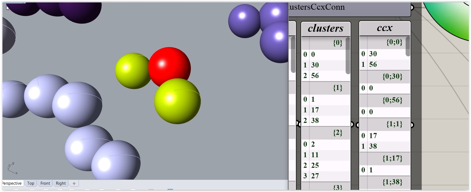

Given the opportunity here’s some visual clues:
With a random (jittered) order collection of objects this is what we call flat hard clustering (Rule used: Ccx events). The clusters Tree samples the indices of the items making the cluster islands. The ccx tree tells you what interacts (according the Rule) with what. The ccx is made at the clustering Method saving several milliseconds (never ask the same question twice).
Given a List of Breps … the {0;0} in the ccx tree means cluster 0 and item with index 0 (the red one) that interacts (according the Rule) with items with indices 30, 56 (the yellows). Item 30 interacts with 0 and item 56 interacts with 0 as well. So the ccx must be a 2 dimension connectivity tree.
