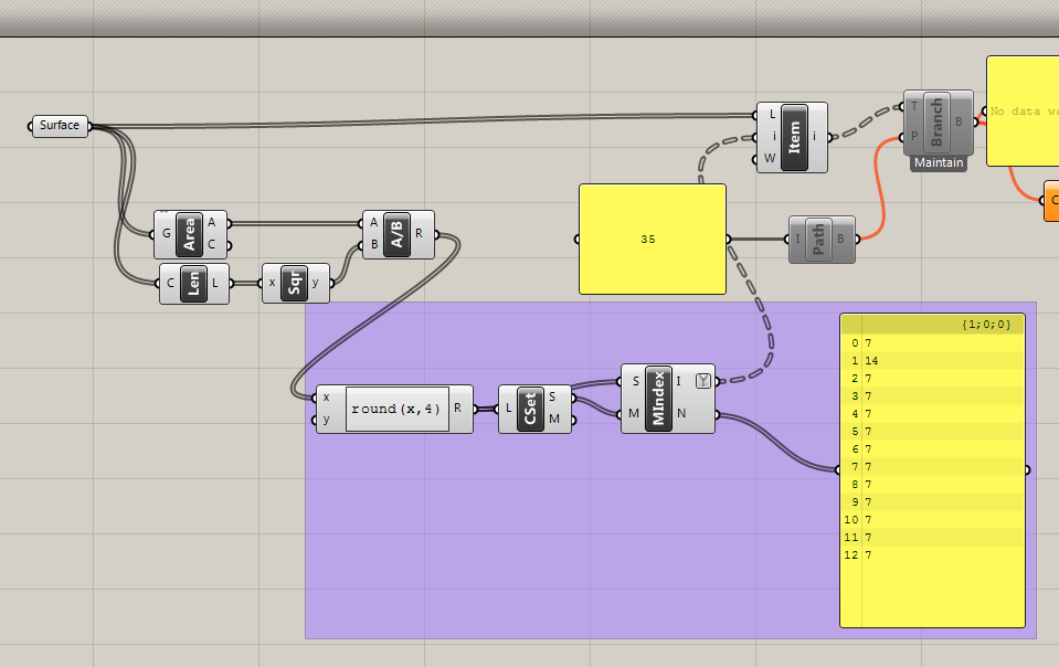

It would be quite helpful if you were able to tell us how many shapes (if any) in your file ARE similar. I took their areas and divided by the square of the boundary lengths to come up with a dimensionless number for each surface. They’re all in the same ballpark, but a few are the same. If any two shapes were similar, this value should be equal because one surface is just a scaled version of the other and the scaling factor cancels out in the division. (it still doesn’t absolutely guarantee they are similar though!).
surfaces -2.gh (35.2 KB)
I’ll just add, that if you round the division to 4 places, the number of distinct surfaces decreases drastically and to 3, even less. I don’t know how precise your structure or molding process need be, but probably this is more what you were hoping.

This won’t work with triangles with equal area and Perimeter but different angles.
As I said, IF two surfaces ARE similar, that ratio will be the same, but just because the ratio is the same does not imply similarity. It’s just one filter you can use. I don’t know how you generated your surfaces so I can’t say how reliable a method this is. If the curvatures all were within a certain range, I’d have more confidence than if they were all over the place. Why would you believe there are any similar surfaces to begin with?

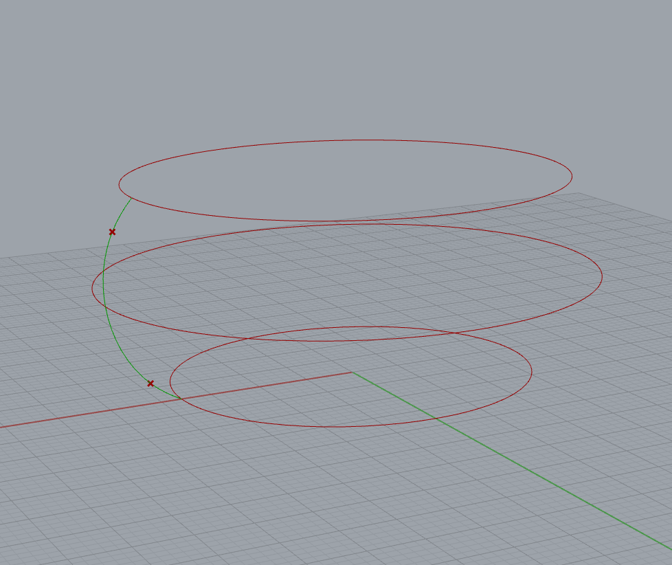

If your vertical curve was a circular arc I think you’d minimize the number of different panels. Or, is it important to you that it is not?

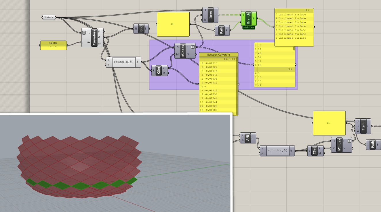

Because of circular symmetry you’re going to get similar curvatures for each layer that Lunchbox gives you. Here are diamond panels that separate into 14 classes in the z direction according to curvature at their centers.
surfaces -gaussian.gh (43.0 KB)
thank you Ethan, that was exactly what I want to have. I know that the results are different, but that’s how it should be. You can choose if you want the smooth panels or the more edgy one :slight_smile:

It’s the area divided by the square of the circumference (sqr not sqrt). Imagine a square of side 1. The area is 1 and the circumference is 4. 1/(4^2) = 1/16. Now scale the square by a factor of alpha. The area is now alpha^2 and the circumference is 4alpha. The new area over the new circumference squared is alpha^2 /(16*alpha^2). The scale cancels out top and bottom.The same applies to any figure no matter how complex, just imagine that you’ve first divided it into tiny squares.

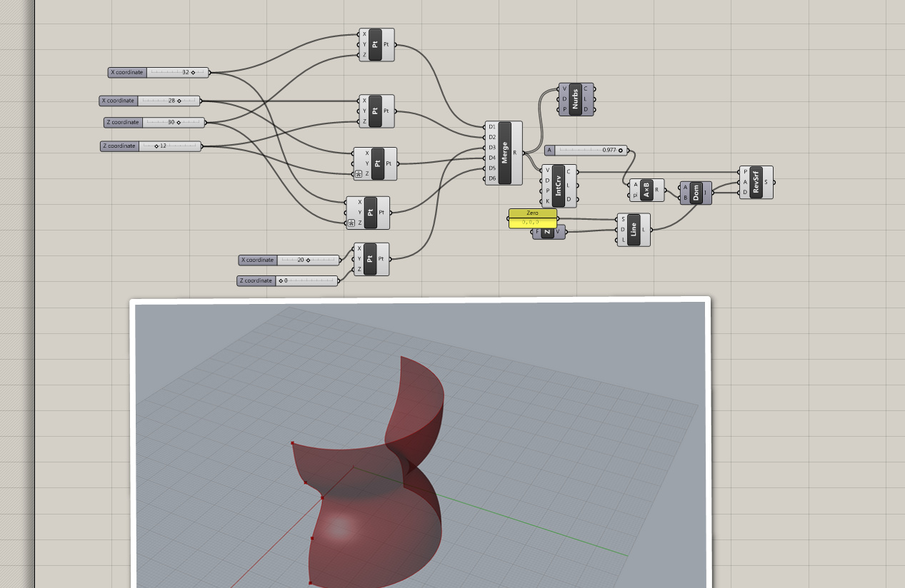

BTW, the profile curve you are using for the sweep has an hourglass shape. It looks pretty symmetrical to me. If it was perfectly symmetrical about the “waist” and the rail curves for the sweep are circular arcs, you shouldn’t need more than five different molds. When I reflect the top half of the surface in the xy plane defined by the “waist”, the two almost coincide. Aesthetically, they’re almost the same, so it’s up to you.
Hello Ethan,
your geometrical explanation sounds reasonable, thank you. :slight_smile: In fact the surface was not 100% symmetrical. Now it is, and I only got 5 different types of surfaces. I wanna do the same with my curves. I dont know why, but there are some curves not identical to the others. But it has to be an fault of grasshopper not of me.

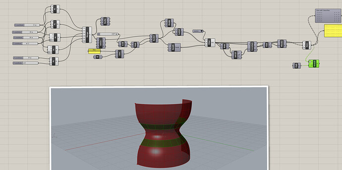

Paul, every time I look, things have changed dramatically and now there’s so much going on that I’m not sure where I should be paying attention. Would it be possible for you to start with something like what I’ve attached below. It is a surface, like the one you initially created but “guaranteed” symmetrical about the middle. The method I used is a little simpler than yours, so maybe there is something in your requirements that I’m overlooking. Maybe we can start from there.
symmetrical profile.gh (11.8 KB)
Because of all the symmetries involved now, I really don’t think it should be any more complicated than this. In fact, you really don’t need to compare curvatures at all, but it’s still here just to put you at ease. You have a choice of Lunchbox quads or isotrimmed surfaces.
symmetrical profile 2.gh (16.1 KB)

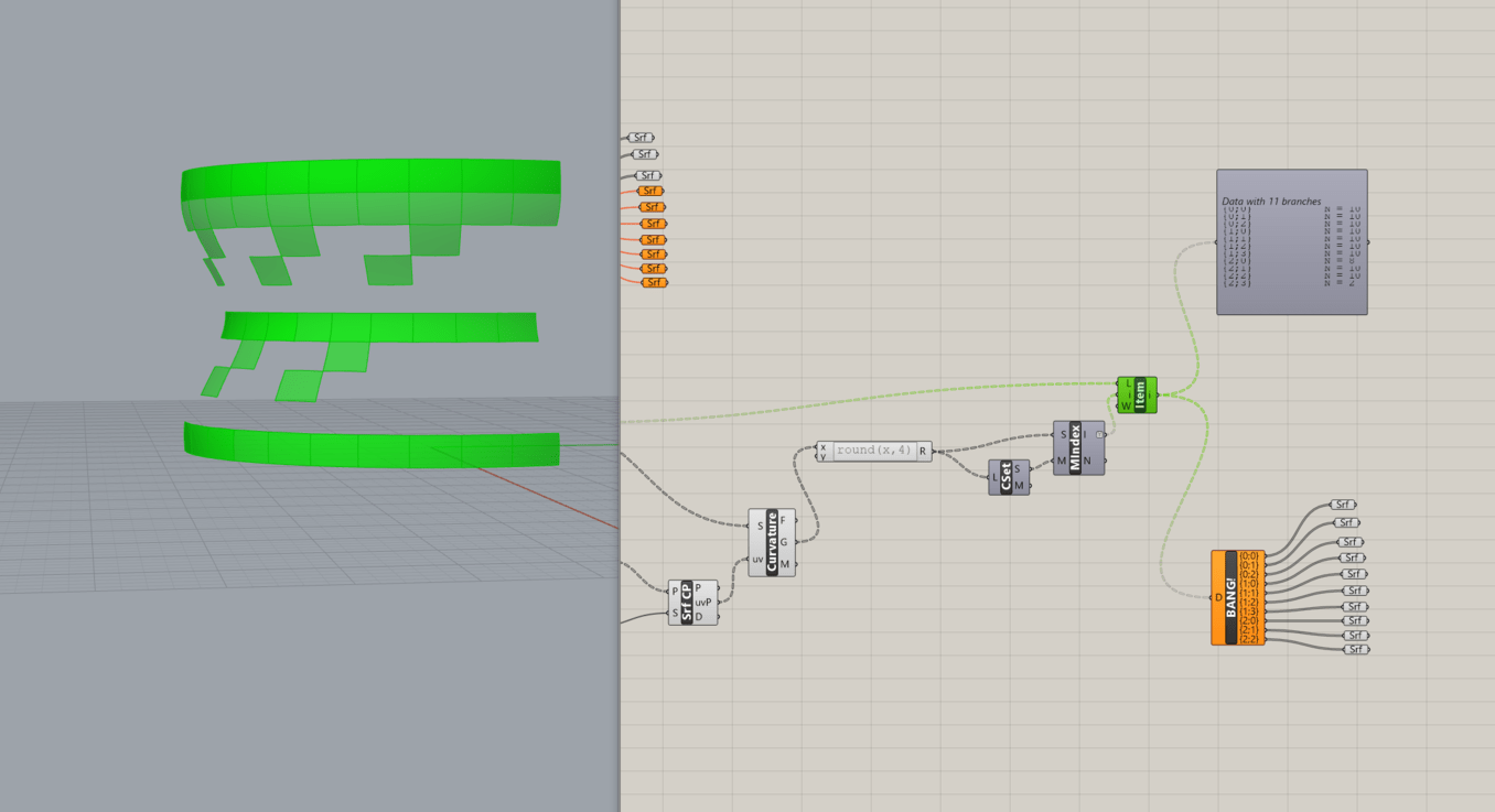

Could you explain what you need the individual curves for?

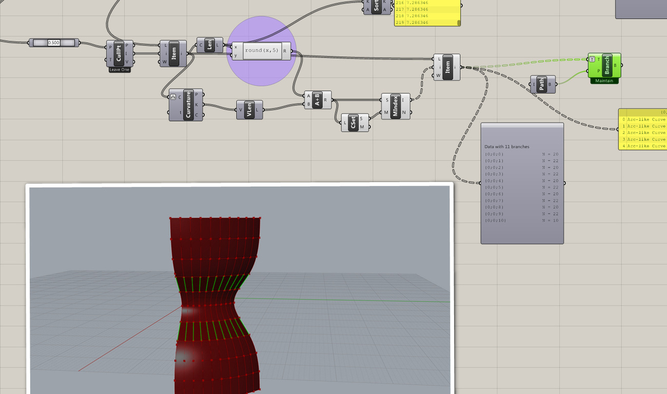

Does this help? I think part of the problem is that there are small floating point differences in lengths that should be the same, so they also appear as different in the sort and add those extra branches. I rounded the lengths to 5 places. Based on the symmetry, there should be 11 possibly different curves, which is the number of branches we get here.
symmetrical profile 2b.gh (53.2 KB)
Hello Ethan,
my project is a facade. So its interesting to know how many types of facade profiles you have to order :slight_smile:
