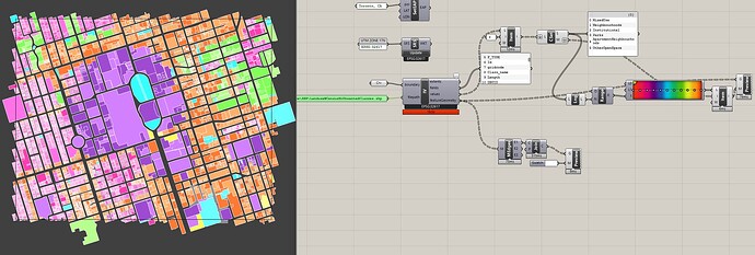

So I’m trying to import land use GIS information into Rhino but I need the layers for each category. I tried doing a little bit of digging around how this could be possible and ended up downloading gismo. I have no idea how to use the plug-in so I want to ask if it’s even possible, or if anyone has any advice on it?
https://borealisdata.ca/dataset.xhtml?persistentId=doi:10.5683/SP3/1VMJAG
this is where i’m getting my data, and I’m using QGIS to access it, but if there’s a way to import the data while retaining its layers, that’ll also work fine.
Thanks in advance

Hi @user1919
Heron outputs featured geometry. The output are meshes. For each mesh there there is a bunch of key value pairs. You can use Jswan the get an overview ( see picture I posted befor).
If you want to bake then in layers you can use elefront or pancake

Hi @user1919 ,
Your TorontoLanduse Corrected.zip - Google Drive was read in Gismo without issues.
Here is the result:
Toronto land use 20240310.gh (53.3 KB)
Download the attached .gh file, and just change your PC’s location (folder) of the .shp file. And set the toggle to “True” to run the “Read shapefile” component. That’s all.
If you would like to make some other “coloring scheme”, then change the index input. In the upper screenshot I used index “8” which corresponds to “Class_name”.
