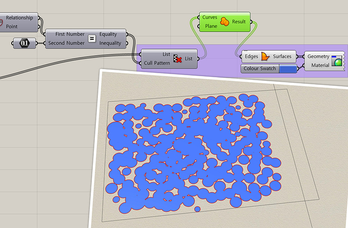

OK, check this out:
Hi, I still want to figure out my own way at this moment. The only thing I couldn’t do is to erase those circles outside the rectangular I put in. What should I do? Please help.
test-restrictedInRec1.gh (9.7 KB)
Thanks for your help. I have some questions for your definition:
C(Curve)input of Point In Curve only takes curve parameter, not rectangle. They are different. You need datatype conversion.
Kim, thanks for the explanation.
I see. In my previous definition, I put an attractor line to seperate the circles. I wonder if this still work in your definition?
?.. You mean this?
You can scale circles ;you need Pufferfish or use standard component
test-restrictedInRec2.gh (13.1 KB)
