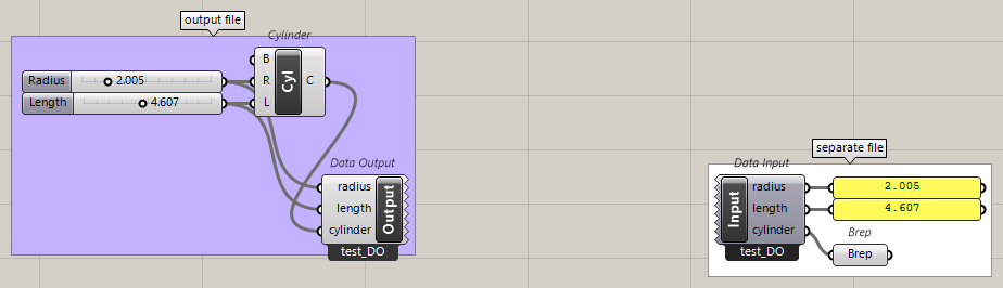

It looks to me like you are not. Sliders would be connected to separate inputs on a Data Output component to create the file, then in a separate GH file Data Input is used to read it. I put both in one file to keep this simple.
test_DOI_2024Jan11a2
test_DOI_2024Jan11aa.gh (5.8 KB) (UPDATED)
