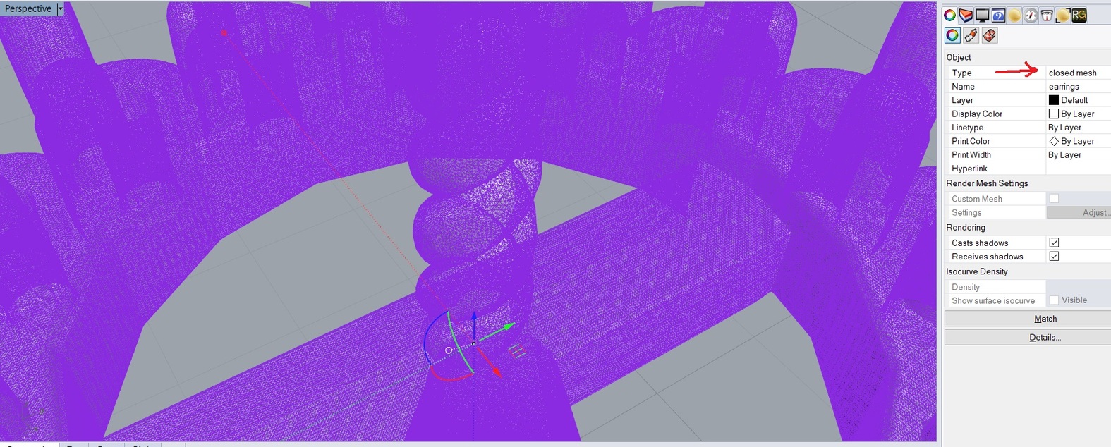

after an hour of playing with that thing
still mesh is opened
reduced mesh a lot and repaired a lot indeed.
Should be some quicker way to smooth and watertight the mesh
**1 hour of life for repair a file :slight_smile: **
our life time is important! cannot buy it
I go out now :sunglasses:
post any ideas
@Rebecca_Taieb @Steff_Wills
:slight_smile:

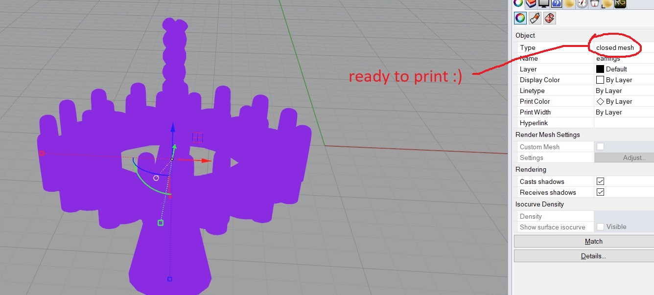

I did it !! haha
happy about that
checked with some other files too.
with simple files 10-15 minutes work. I can do now ready for printing quite quickly :smiley: :smiley:
smooth and blended sharp edges too.
everything is like waterflow :wink: so happy
thank you for beeing here
best regards
Peter
