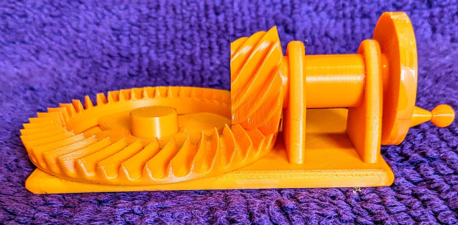

That’s an amazing example Seghier - thanks for posting it. I’m going to see about using it to make a 3D printable model that works via a small hand crank. Here’s what I’ve come up with so far:
The pinion gear needs some work because it has to have a flat surface to be printable. And it should have a better crank handle.
