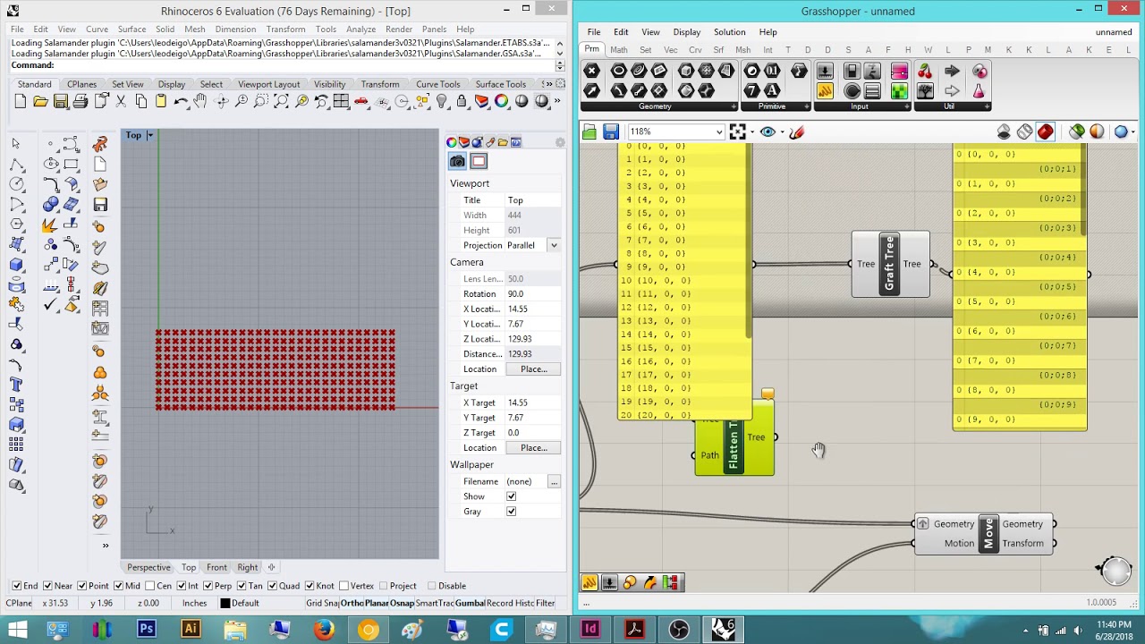

that’s fantastic thank you, what does flatten actually do?
HI @ashcoaster3
Flatten just low the level of a data tree. I recommend you to look for some videos about that in youtube since it is plenty of good staff to learn about data trees. Example:
