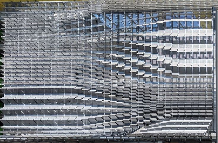

Hello! So I am planning to do similar result, but how do I attach curve attractor instead of points? new here to grasshopper ![]()
Divide the curve into points.
it worked, thank you!
