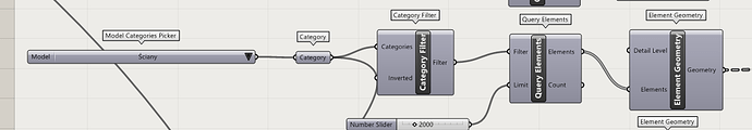

Hi, I want to select only nontransparent elements for daylight analysis, however selecting walls also selects curtain walls. Is there a way around that?
Not knowing the particular types I came up with this solution.
It Queries Elements by Category then provides a set of all Types found, which you can then select which types you don’t want, then does another query combining the category filter and inverted type filter.
Re_Filter_Category_and_Type.gh (8.2 KB)
