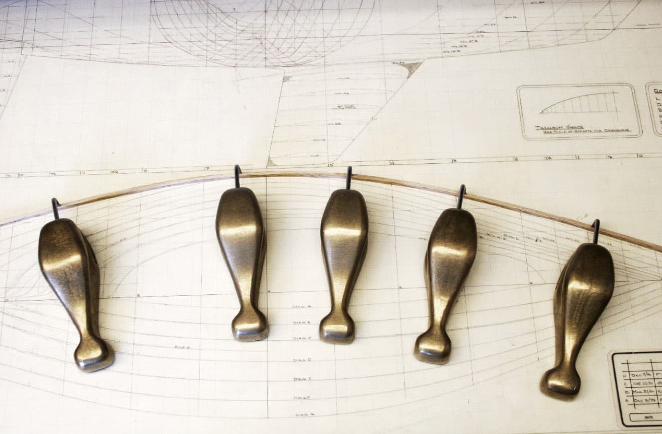

nurbs describe the physics of a wooden “spline”.

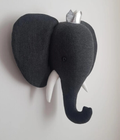

for meshes i like the mosaic approximation of an elephant shown above.
