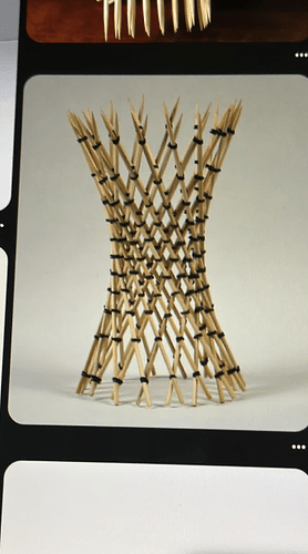

Does anyone know how I can model something similar to this? I want to be able to control and adjust it as I am designing a pavillion/ installation of sorts. any direction could be very helpful.

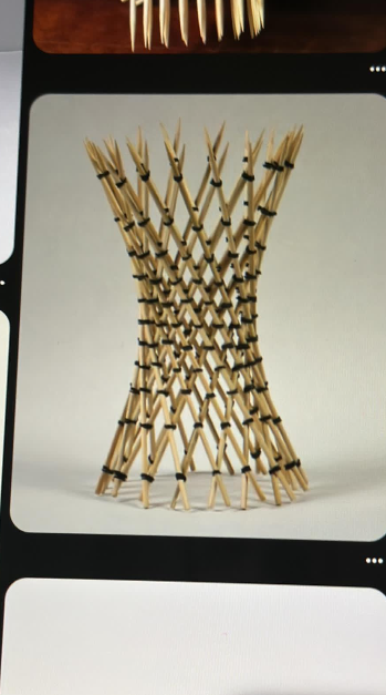

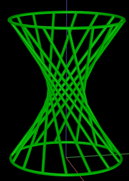

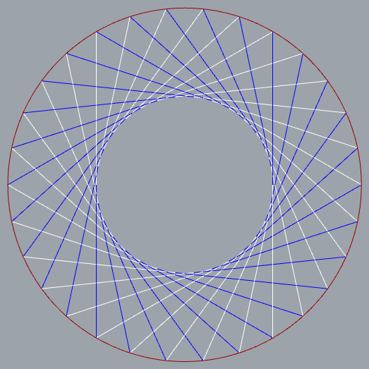

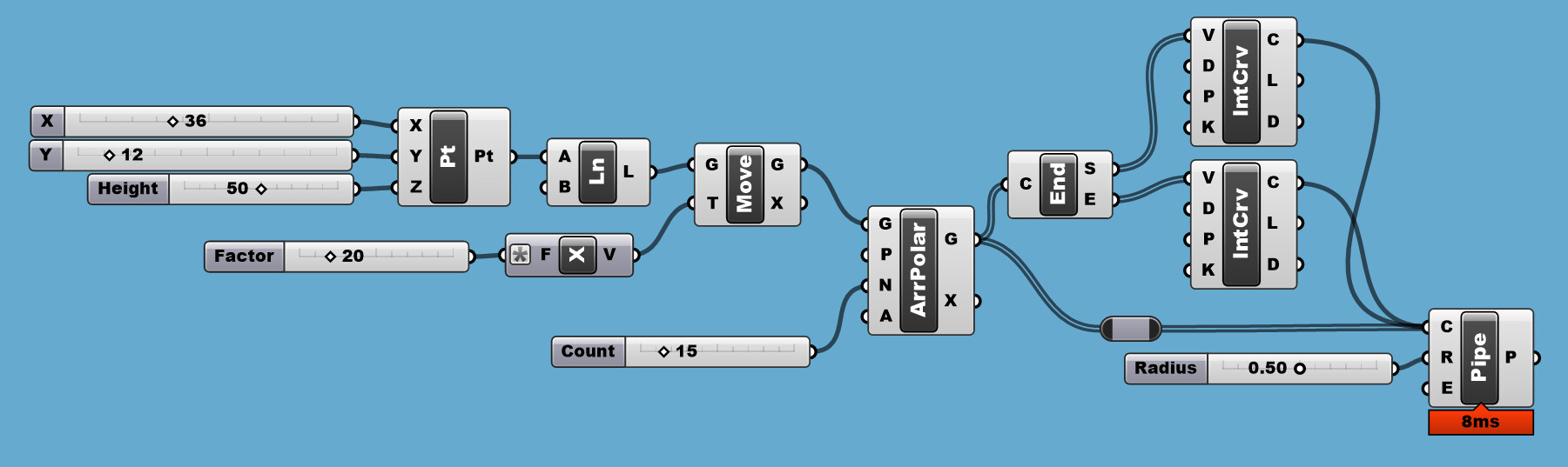

Divide two circles, connect the points with lines and rotate at least one of the two circles.
Rotate in both directions to get the crossing look like in your image.
