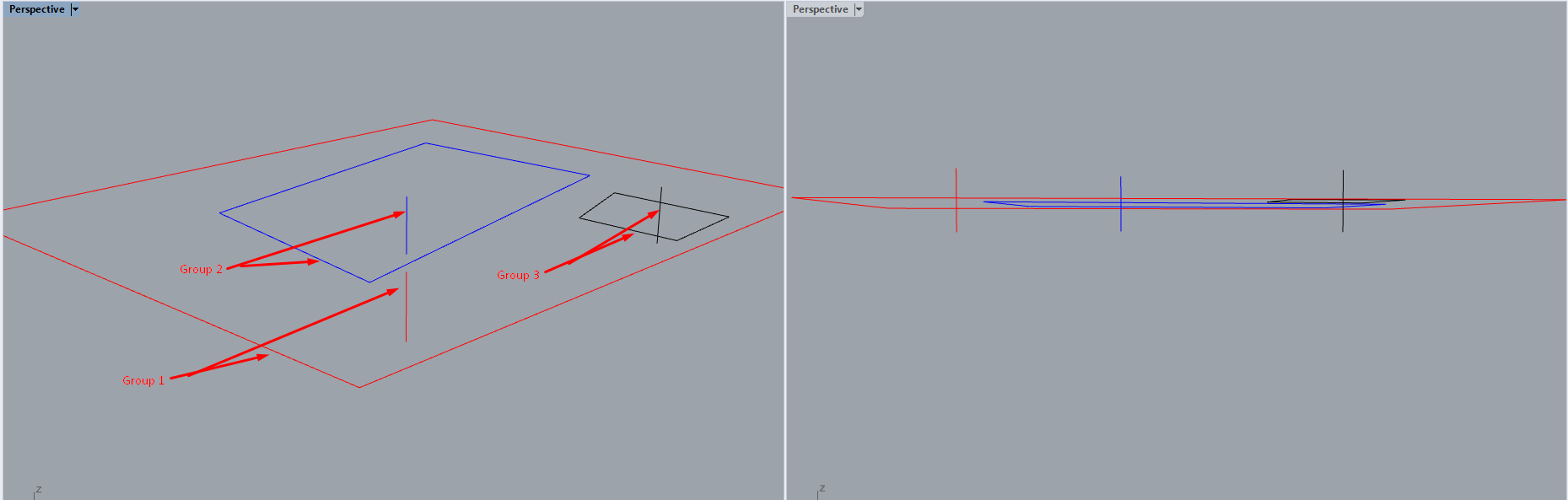

Hi Guys,
I have a quick question. Is there anyway to determine those vertical line belong to which closed curve? Kindly note that, those closed curves are on the same plane and vertical lines ain’t.
I have attach herewith a sample file for your reference.

If you only want the get the inner curves:
it18.gh (22.5 KB)
@Mahdiyar Thank you very much
