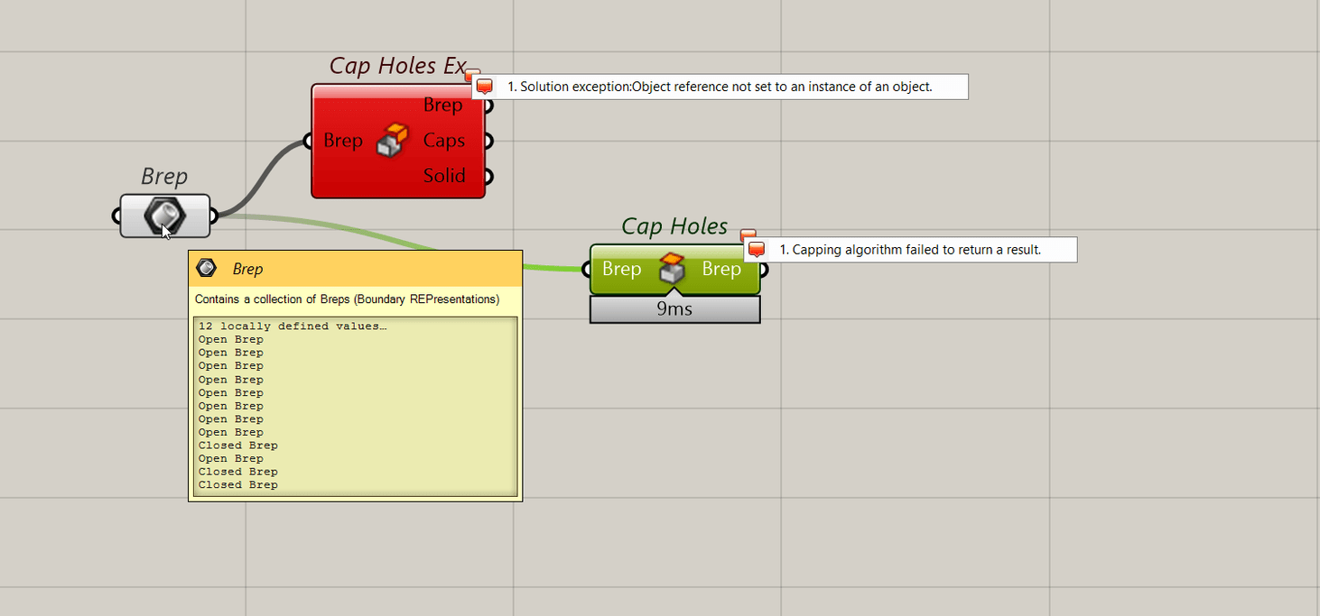

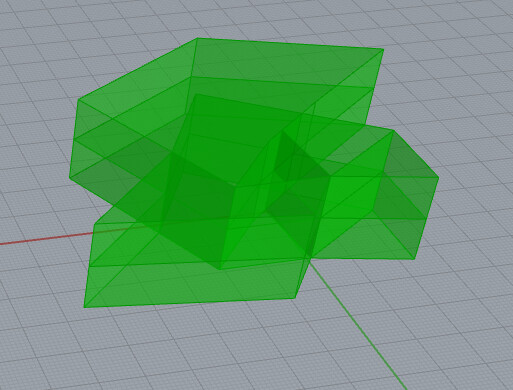

I have few spaces baked as breps
unfortunately, only two are closed

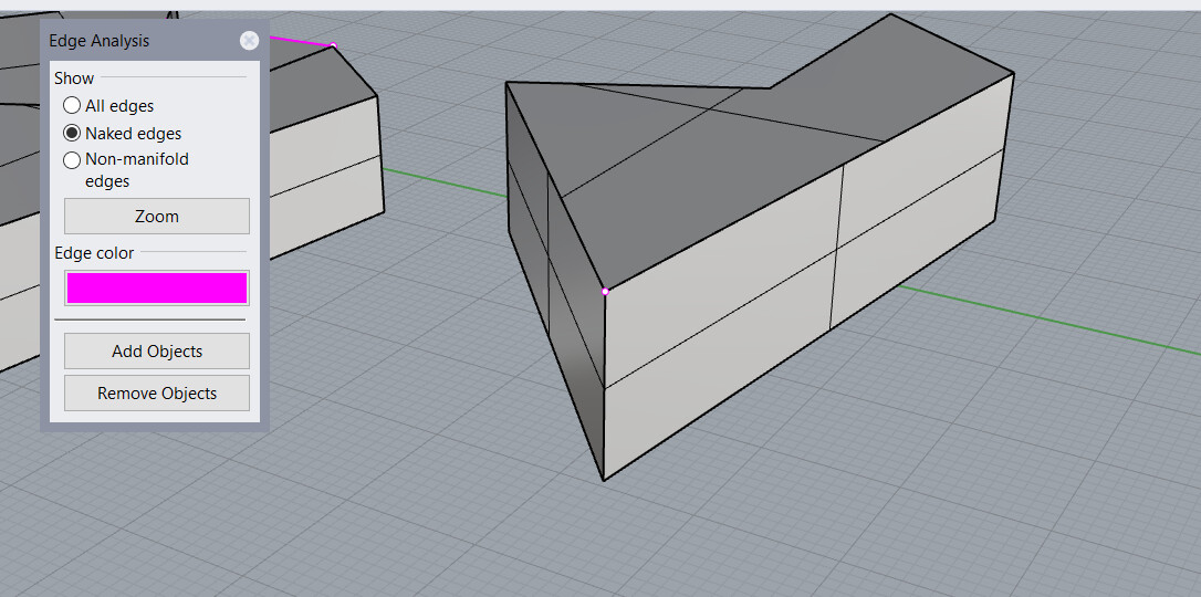

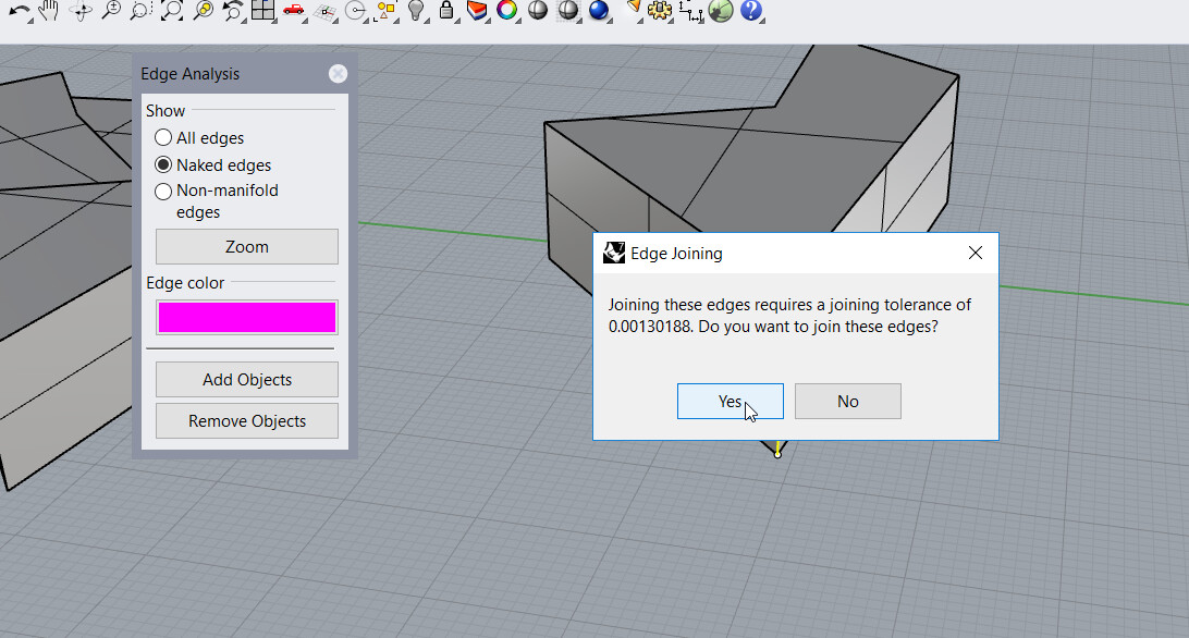

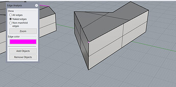

I visualised in Rhino naked edges and tried to merged edges… seems to work but still, one point is left

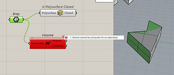

when I load this into grasshopper it shows me that is still open polysurface
I tried standard solution but did not work
Q1. how can I fix this in rhino to remove this point… would that make it closed?
Q2. Is there an alternative way to close my breps in GH?
I guess this is a complex subject but maybe there is sth I missed…
breps.gh (42.0 KB)
Hi Michal!

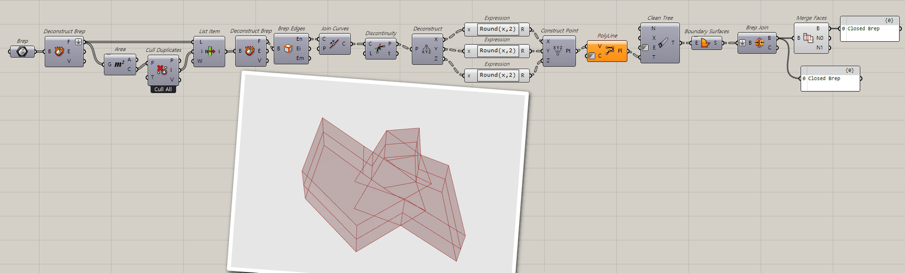

I don’t know why this happens. :frowning: but usually when you explode and re- join the polysurface in rhino make closed polysurface. for grasshopper I don’t have any idea except using python rhino library to do the same procedure.

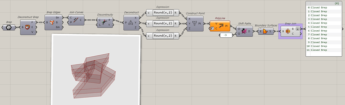

If you consider this case as a kind of tolerance issue…
breps_re.gh (49.7 KB)
It closed 8 out of 12 by exploding and joining, not bad…
thanks it worked on all of them I just think if rounding to two decimals will not mess up whole building…
