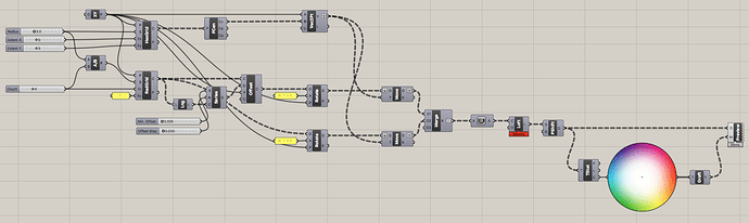

If I were to do that, how do I get the lines inside the hexagon I created onto the grid?
Welcome @laurenprestipino,
Is this what you want to achieve?
In Grasshopper there are usually many roads that lead to similar results! Here’s how I achieved this:
Please note that if you require help in the future that it’s customary around here to provide a file that people, willing to help, can inspect.
hex_grid_panels_01.gh (14.5 KB)
