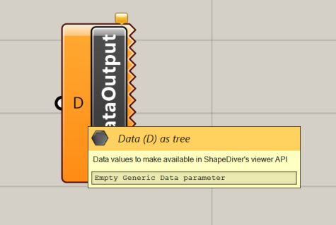

How can we use ShapeDiverDataOutput?
I have tried to use it to show some calculations on the model but I do not see any output. Where should I look for it?
Hi @mateuszploszajmazure this is Edwin from ShapeDiver, have you checked our API documentation? That is the way you can access data Outputs from your model. Link: https://shapediver.com/api#getModelData

Can I use it without creating my own code, just with the basic shapediver app that shows model after upload?
Hey @mateuszploszajmazure, DataOutputs are meant to be used using our API as its description shows.

In the Api v2, the data is available through the scene interface. You can either all the contents of the scene (geometry, materials and data) by calling api.scene.getAsync() or just the data using api.scene.getDataAsync().
When I did that with your latest model, I found one data output:
{data: "4€", id: "9c56a488f97155879cbafaa5ac7dc3f5", name: "ShapeDiverDataOutput", plugin: "CommPlugin_1"}
By the way, I notice that you didn’t give a name to the ShapeDiverDataOutput component (which still has its default name). If you give the component a name (in this case, for example “Price”), it makes it easier to find through the API using a filter: api.scene.getDataAsync({name: "Price"})
