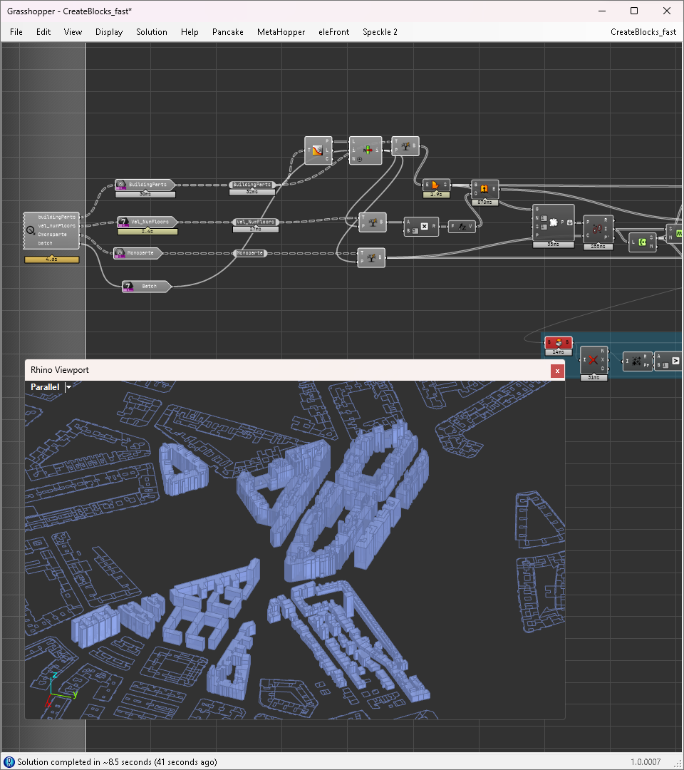

Hello, we are trying to work with urban data (100k polygons) inside grasshopper. We organize the file with ‘hops’ but we are getting this error.
@AndyPayne Any possible solution within the jumps or do we have to batch process the geometry outside the component? Would it be possible to increase the allowed body size?

@little_grasshopper I guess there are a few options available to you. The first option would be to simply pare down your Grasshopper “function” so that the data you’re passing in it would be smaller. Can you break the Grasshopper file you’re using into even smaller parts (instead of one large definition) and only pass the data you need into each function? That’s probably the easiest solution, although it might not be possible in all scenarios.
The next option would be to clone the Rhino.Compute git repo and build the rhino.compute server from source. I don’t know how familiar you are with git or building projects using Visual Studio, but the process isn’t too difficult if you have a little programming experience. If you can build from source, then the line you want to modify would be line 93 in Program.cs in the Rhino.Compute project. Basically, this line sets the maximum limit for HTTP requests. The default was 30mb and we have already increased it to 52,428,800 bytes (50mb). But, obviously, you’re running up against this limit so you might need to increase this value and then build the server again. Or, you can set the MaxRequestBodySize to null and it will then allow an unlimited request body size. So, line 93 would look something like this:
options.Limits.MaxRequestBodySize = null;
Once you build the server, you’ll need to run it manually, and then make sure you enter the URL and port number in the Hops preferences section so it knows to send the request to that server and not the one that gets automatically spun up when you launch Grasshopper.
The last option would be for us to make that change and issue a new build of Hops. This is certainly doable, but I need to talk with the rest of the team to see if there are any unforeseen problems with us doing that. I will let you know if we do publish an update. I hope this helps.

I’m thinking just setting the MaxRequestBodySize to null makes the most sense, thus eliminating the request size limit all together… but I’m just checking with a few folks before making that change.
@little_grasshopper I’ve just pushed a new version of Hops (0.15.2) which now has an environment variable which you can configure to increase the request body size limit. You can now create an environment variable called RHINO_COMPUTE_MAX_REQUEST_SIZE which sets the maximum allowed size of any HTTP request body in bytes. The default value is set to 52428800 bytes (approx. 50mb). Try downloading this latest version and then setting a larger request size limit via the environment variable and let us know if that fixes your issue.

it works! The “Request Body Too Large” error no longer appears. But another new one was shown.
