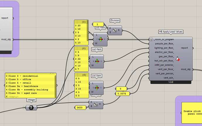

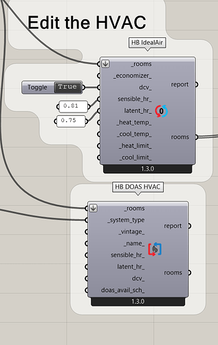

I am generating a script to run the energy simulation via grasshopper. However, I found it bit difficult to keep consistent with settings in IESVE.
IES setting for DTS run, image showing what’s in the GH script:
- space condition - heating cooling profile and setpoint
- internal gains - people lighting equipment
- air exchange rates
- thermal performance values for - external walls, internal walls, floors, roof, internal ceilings, glazed windows/doors
*fan coil systems: heating (type gas or elec) efficiency, SCOP, heat recovery, cooling Nominal EER, Seasonal EER, auxiliary energy value, auxiliary energy fan fraction.
I’ve attached the script
Energy Simulation T1 v1.3.0.gh (710.2 KB)
