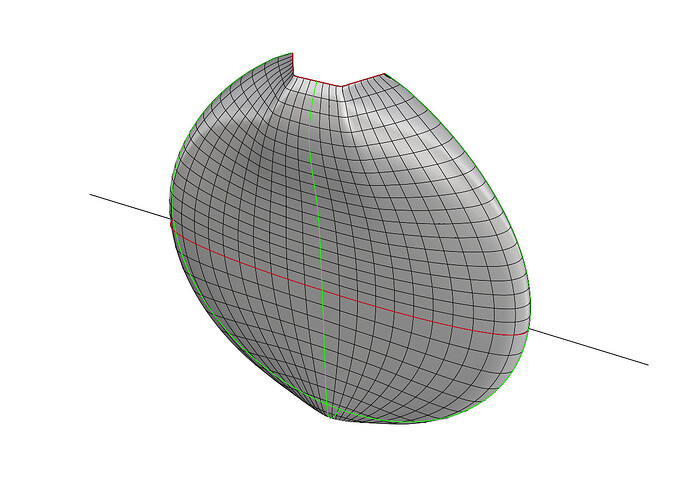

is this somehow what you re after ?
_netWorkSrf
Autosort = No
first Direction = green curves
second Direction red curves
(the result is not a very high end surface quality - more a fast sketch )
thank you that is exactly what I was trying to achieve! I followed the steps you gave and was able to make it work.
