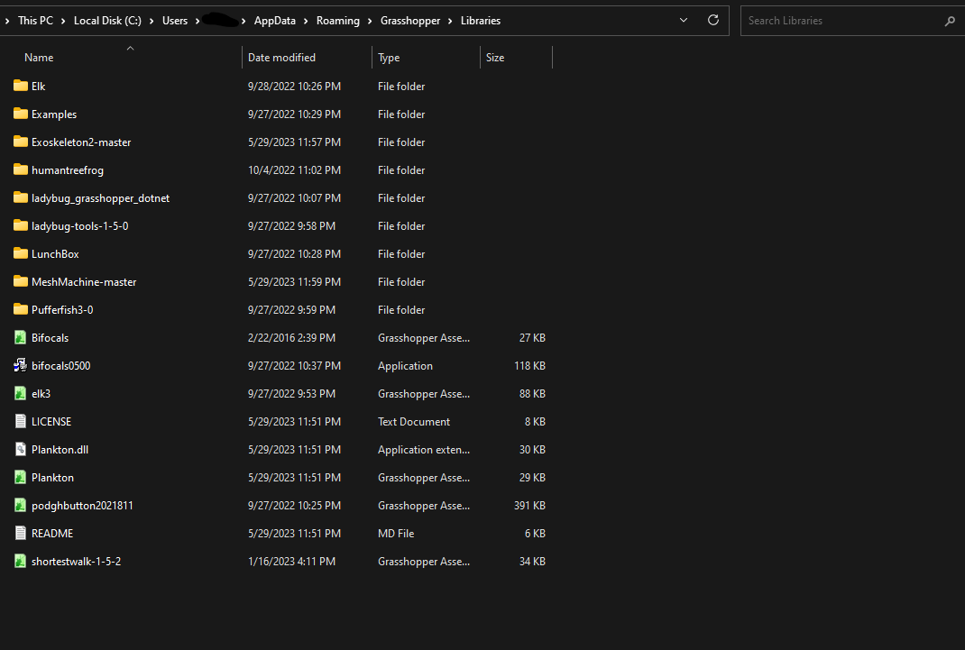

I download the zip files and extract them to
C:\Users\d*****\AppData\Roaming\Grasshopper\Libraries

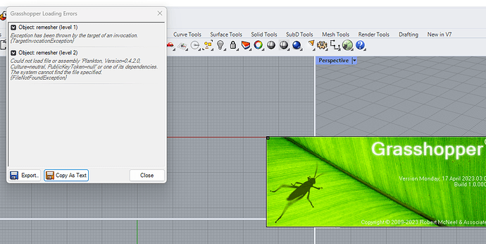

After restarting Rhino and opening Grasshopper, this error pops up.

I understand the “unblock” aspect within the file properties when it comes to importing plugins, however I do not see a .gh or .dll file to unblock to begin with.

What you need is to add (and unblock) the PlanktonGh.dll file to the same directory.
Here’s a zip with all 3 files
Plankton.zip (45.0 KB)
As for why it was this way:
gha file types are actually just dll files with the extension changed.
For Grasshopper to load the Plankton custom data type correctly it needs it to be a gha.
However, in VS there was no straightforward way to reference a gha, so MeshMachine and Exoskeleton2 referenced the dll. So to get both the Plankton parameter component working and MeshMachine, you needed both the dll and the gha (even though they are actually exactly the same file except for the name and extension).
