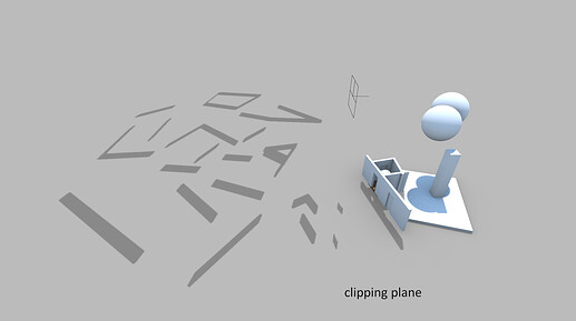

Sections are producing quite unexpected display mode and are bringing ghosts to your scene. I thought they are clipping the 3D view exactly the same as Levels but they are not.
Levels act with shadows pretty much as Clipping Planes.
Skylight Shadows in Rhino are awesome, so having them working correctly with VA is important for me.
haunted scene.3dm (12.4 MB)
Display Mode:
Rendered - Shadows 2.ini (12.8 KB)

But I do want shadows to ignore clipping planes :). The problem is not shadows cast by invisible objects on visible objects, but that invisible objects are being shaded. Clipping Plane is working just fine, but of course it lacks functionalities of the Sections.
VA Section
Clipping Plane
Settings you asked for, but not a desirable result
OK, sorry, I understand now.
Let me check if I can fix this issue easily.
Enric
Hi @Czaja,
I’m fixed this bug in VisualARQ 2.11.3. We’ll publish it next week,
