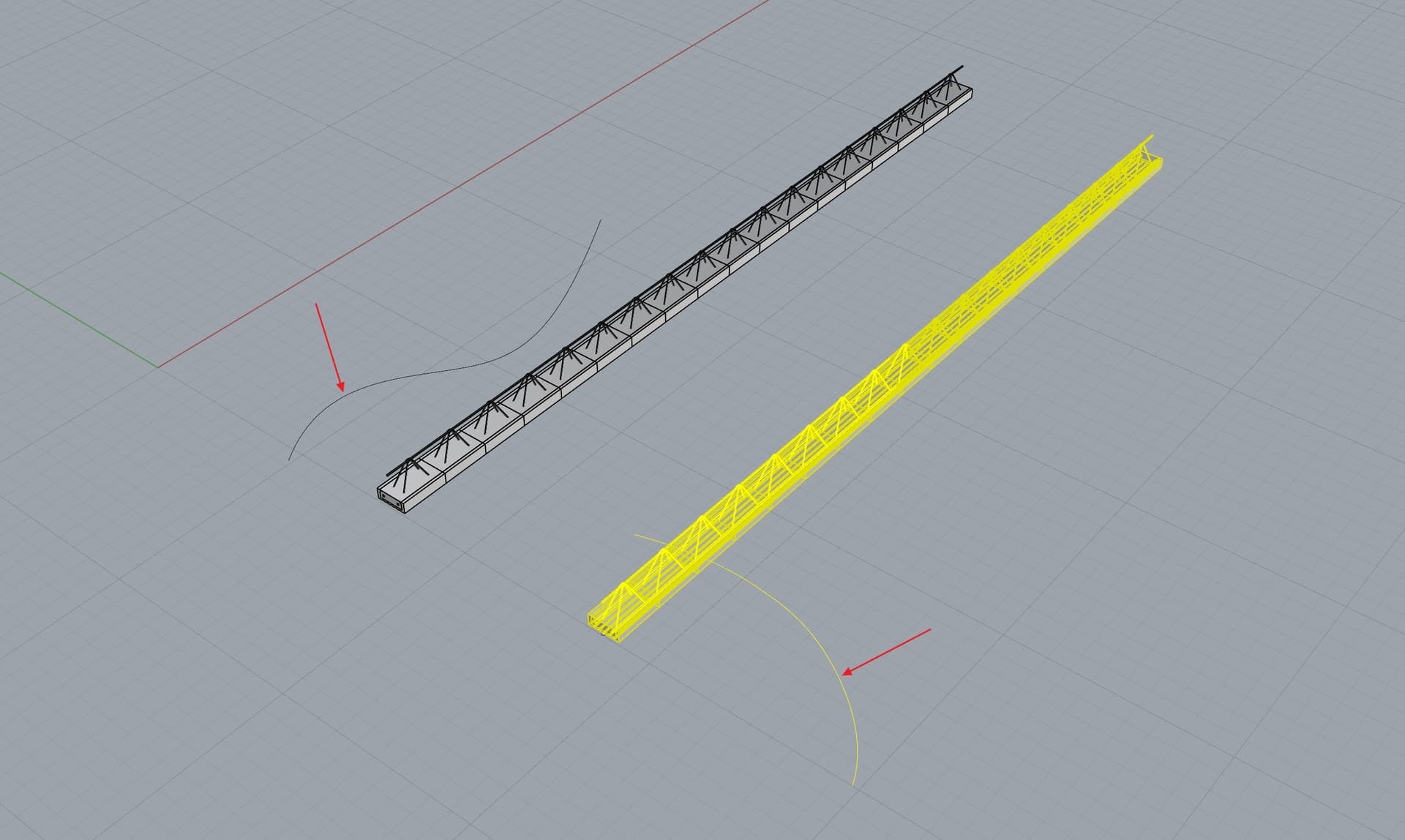

Two VA GH Style Elements with only differences that they have different Per Object Curve. Because of that file doubles in size…

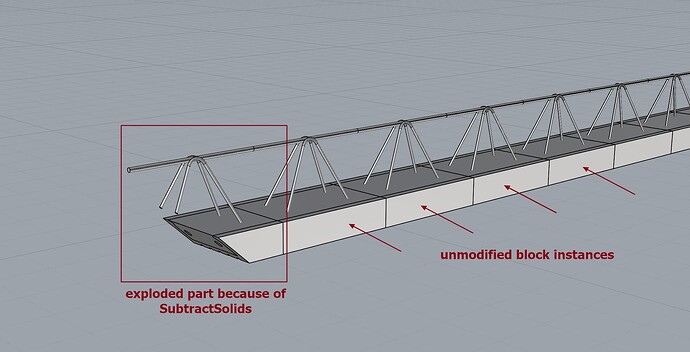

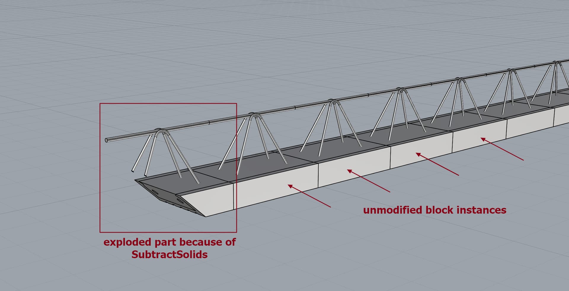

Maybe I should point out now that it would be cool if SubtractSolids only exploded the Block Instances that it collides with to create new geometry (in which case, if I understand correctly, exploding is unavoidable) and the rest remained Block Instances.
Heh, this doesn’t work at all now in the VA 3.5 RC 1…
2 steps forward, 1 backward.
belka strop 4.3dm (3.0 MB)
Hi @Czaja,
You’re right. I forgot to implement that part, sorry. I’ll do it tomorrow, so it will be fixed for the next RC. I just need to explode the block when the bounding box of the block intersects any of the subtracted geometry. Any block instance that doesn’t intersect won’t be exploded, of course.
Enric
