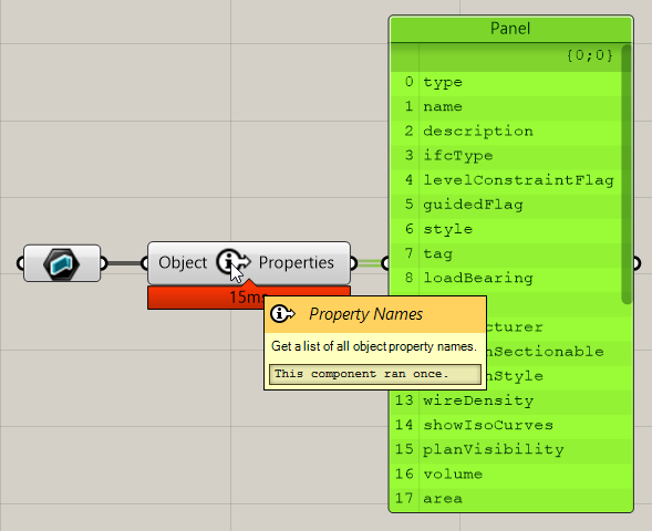

Hi @luisbarthelemy you can figure out the strings to be used in the syntax for obtaining the host object properties/parameters in the “Property Names” component:
If the host object is a wall created as a Grasshopper Style, the Property names should also display the strings of that wall parameters.
