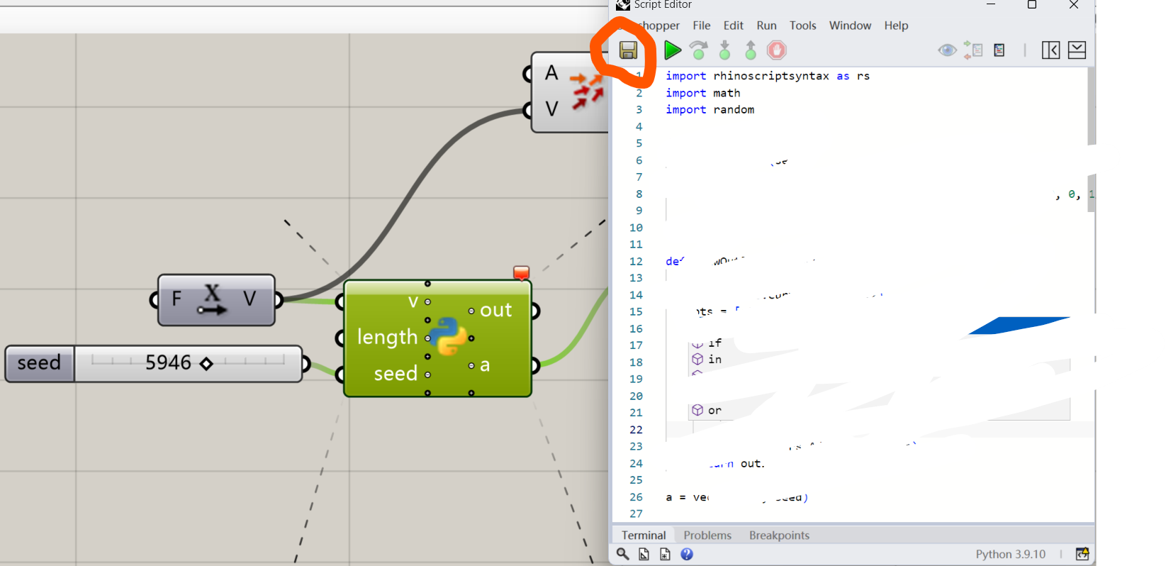

Hi, I have a problem when writing ghpython in Grasshopper. The script editor window auto shut down every time I save my python script (pressing ctri+s or the save buttom), but I haven’t completed my code so I have to reopen it, which is annoying. Is there any way to keep the window on after saving?
Perhaps Grasshopper is trying to run it, and the code and Grasshopper set up then causes the crash.
Disconnect the seed 5946 and F X V components while working on your code.
Mine either, R8.5. Ctrl+S will shut down the script component.

Is it possible I can save the script without closing it?
Some tests might crash Rhino, so I like save it beforehand, but I also don’t like to shut down the Script window, because I need to test(experiment) a lot to see and understand.
Of couse. I made a ticket for this and will take care of it for 8.6:
RH-80898 Add Option to avoid closing editor window when saving in GH
Thank you very much!
