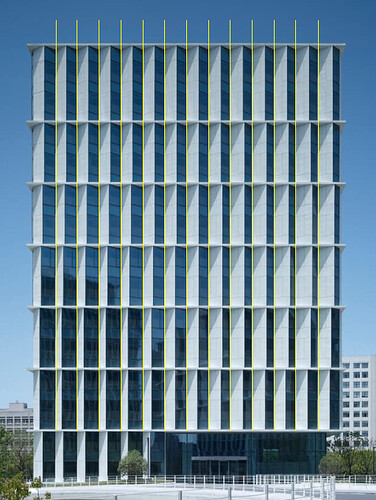

I am a beginner in using grasshopper. I am looking to build a script to create the facade below.
Where do I start and what component should I be using?
Many thanks
it looks like the left side of the non-glass panels is fixed and only the right side changes:
mine is for sure a very bad sketch… but assuming a coordinate system like the one in the following, it looks like the most external edge of each panel has the very same Y coordinate (marked a few, visible everywhere) so they don’t all share the same size
apart from beauty, “relevant reasons” might be there to justify why the facade panels have a particular opening range, for instance sunlight :slight_smile:

Your image looks interesting but it’s difficult to see the algorithm behind it, perhaps because the faces don’t look consistent? Is that because of an attractor point?
I don’t see why Rhino.Inside.Revit is required?
3Cubes Office Building / gmp Architects
Caohejing Business Park in the western part of Shanghai, China
This has no attractor or “3 specific angles” but it sorta works?
saw_tooth_2024Aug14a.gh (26.6 KB)
  • The white panels on the right of each pair are all the same size.
  • Each pair (combined) uses the same X dimension.
