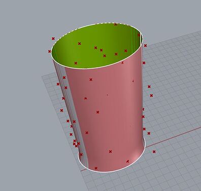

Thanks for the info about populate, when I run the populate feature, the adds the points in however they are spread out in the 3D space, is there a way to “flatten” these on to the surface and then assign droplets to the points?

that looks like Populate 3D, here is Populate Geometry
