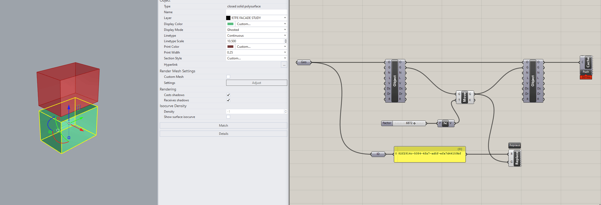

I agree, but I found it a bit difficult to get into at first. How do you push the changes? You need to plug in the Cache component at the end for it to apply the changes in Rhino?
Anyways, I am also a bit afraid that it changes some of the attributes that I am not aware of - see here:
20250624_133555_Rhino_cSJHDnDCwl
Notice that the “Display Mode” override is going back to “By View” when I use your logic. When using “Replace”, it stays as is - here I am really sure that I am replacing only geometry. It seems to me like a cleaner solution. (side note: In the past I had similar problems when baking with Elefront, the layers changed colors, print width etc to default, so I got a bit paranoid.)
Lastly, I would like to know how to make it in Python just for learning purposes. I know that I am almost there but I miss something…

I checked all possible overrides, including Vray (like displacement modifier etc.)
When I use “Model Object - Cache” - then “Display Mode” goes from "Ghosted" back to “By View”
When I use “LegoPod - Replace” - then “Display Mode” stays on "Ghosted" (no change)
Otherwise, so far, everything stays as it was. Only geometry changes. So thumbs up.
But regardless of the “Cache” solution, can we go back to the Python script? Any ideas how to make that one work?

Regarding display modes, I suspect that since display modes are set per viewport, and grasshopper doesnt know what the current viewport is, it would treat it as the majority of display modes (1 is ghosted and 3 are by view so the display mode is by view…or something like that). If you set the display mode in grasshopper and push to rhino then you can see it be ghosted every viewport and in each subsequent query the display mode is still ghosted.
1st query: Queried object display mode is ‘By View’
2nd query: Queried object display mode is ‘Ghosted’
Sorry I don’t have any scripting skills so I won’t be able to help you there.
It makes a lot of sense - well done with detective work!
But that is why it is yet another reason I can’t use Grasshopper “Model Object - Cache”. I do a lot of custom object view overrides in layouts/details.
I just checked two solutions against Layout/Detail Display overrides.
And again:
When I use “Model Object - Cache ” - then “Display Mode ” goes from "Assigned custom (Ghosted etc)" back to “By View ” in all details
When I use “LegoPod - Replace ” - then “Display Mode ” stays on "Assigned custom (Ghosted etc)" (no change)
So “LegoPod” comes on top.
