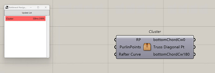

Why does Grasshopper on R8 takes a lot more time to open a script compare to opening the same script on R7? I am getting something like 1 minute vs 8 seconds! Metahopper said certain cluster and python script are the issue but first they have no internalized input data so they should not compute and second deleting them will not make it faster because it somehow makes the next cluster/python component become the culprit so it is like chasing its tail.
Not just that but the interacting is also slower, especially exiting out of a cluster (without saving) takes 5 seconds compare to almost instantly on R7.
Yes I have a massive script ( > 12000 components) but it was much better on R7. No I cannot upload it as it requires our extensive plugin + library set up that is quite complex. I always have auto-save disabled for GH and my hardware is definitely not the issue here (posted below).

Okay so it was not just this script and it wasn’t about the number of components.
The attached script has 1 cluster which contains < 100 components inside.
On R8 it takes over 3s to to open. On R7 it is 0.3s
GrasshopperSlowLoading.gh (33.2 KB)

I tried this and when I load ScriptComponents.gha which enable these C# component it makes the script open significantly slower (0.3s to 1.9s for the script above). Similar thing happens with GHPython but not as significant.
Replacing these old scripting components do not solve the problem and it seems worse when both new and old ones are on the canvas. Could you look into this? Cheers.
