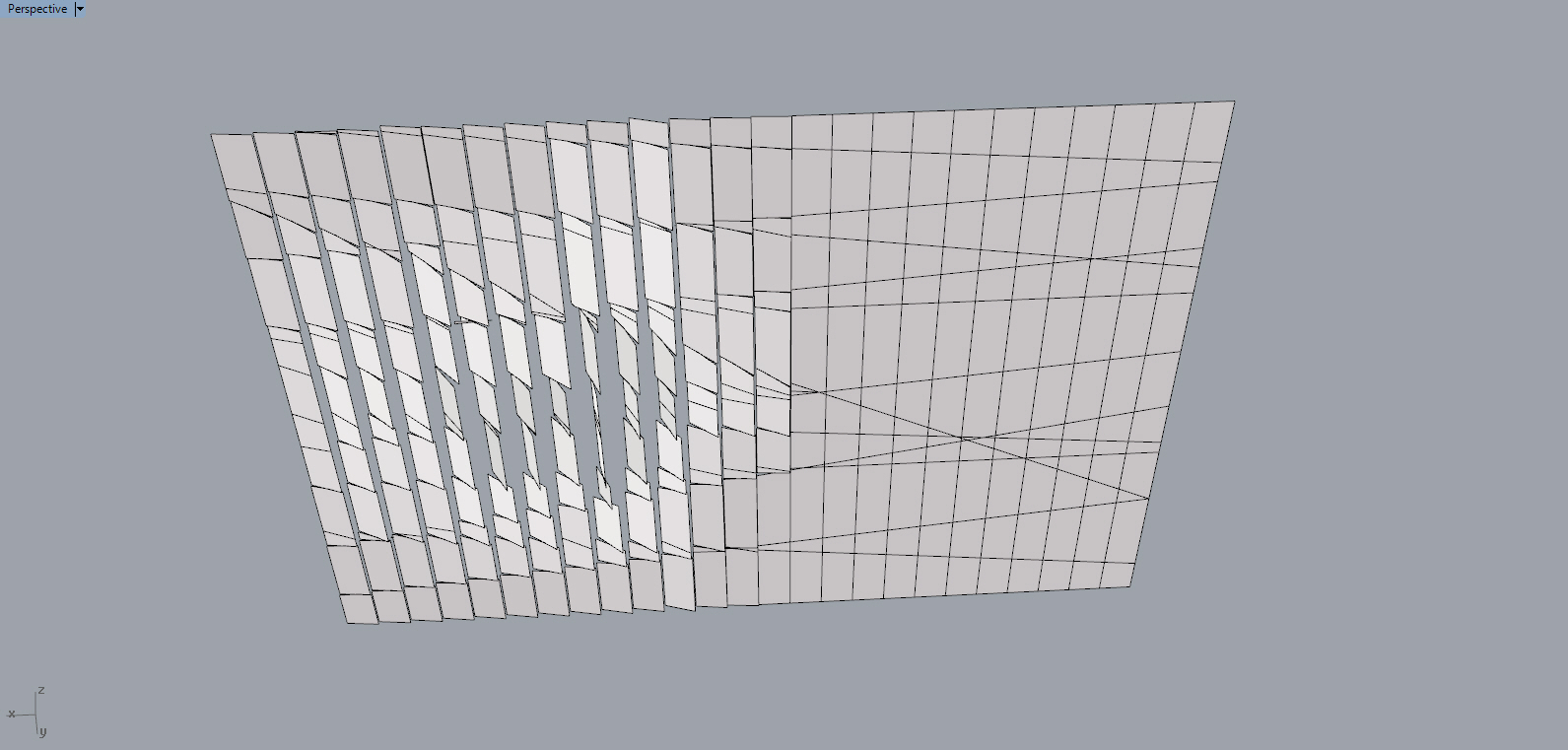

Grasshopper kinetic facade project (problem)
The above image is a simple example of our project facade.
What we want, is a bit complicated, I hope I deliver it well…
(Letters represent each row, Numbers represent each column)
We want, each piece from columns 1 and 8, to not rotate at all.
Columns 2 and 7:
For row A and F rotate from 0 to 10 degrees
For row B and E rotate from 0 to 20 degrees
For row C and D rotate from 0 to 30 degrees
Columns 3 and 6
For row A and F rotate from 0 to 20 degrees
For row B and E rotate from 0 to 30 degrees
For row C and D rotate from 0 to 40 degrees
Columns 4 and 5
For row A and F rotate from 0 to 30 degrees
For row B and E rotate from 0 to 40 degrees
For row C and D rotate from 0 to 50 degrees
The image below is an example of our facade (the rotation has been done by hand in rhino and NOT in gh)
Here is the sample rhino model and the grasshopper we have done for only one column but we can’t do it for the whole facade.
gh_6attract.gh (18.9 KB) OUR GH TRY FOR ONE COLUMN.3dm (1.8 MB)
I hope you get the idea of the project. Feel free to ask more if you didnt get the point.
Thank you in advance.
I think I did what you want to do, but on rectangular grid (logic is the same).
Check attached definition and try to apply it on your project, if something is unclear feel free to ask questions
try this.gh (13.6 KB)
