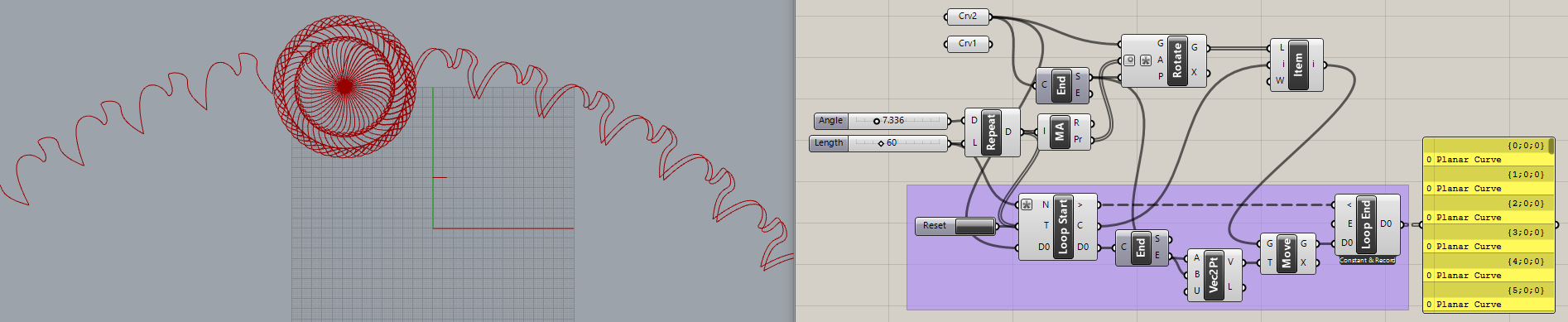

Here a solution which accept whatever open curve in XY plane you want
rotate curve.gh (15.0 KB)
Your curve isn’t internalized.
Must be better now ![]()
WOW! it worked for me but I’m gonna have to spend some time understanding how. I know trig, this isn’t basic for me! ![]()
Will use this to render different configurations of a large video wall for a stage layout.
Thanks so much!
Little error in stream gate , I updated the script.
Follow the flow
I calculate the middle, the direction, then a cross product to have the lateral then some math to calculate the length and then the center of rotation.
