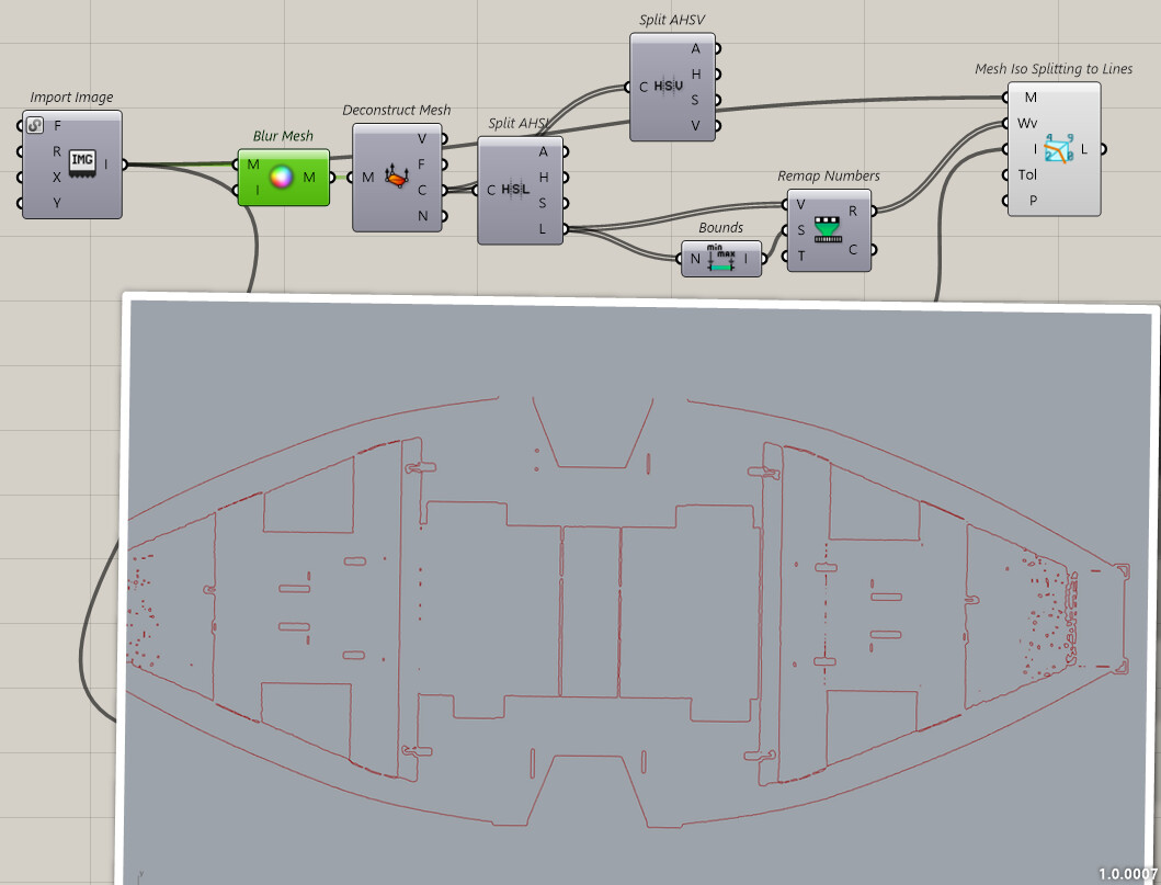

both plugins: Nautilus, by (@laurent_delrieu ) and Graphic+, by (@DavidMans ) offer such tracing algorithms. And if your input images are relative simple in terms of colors, you could try Bitmap+ to extract by specific color and outline
Thanks @Chris37 ,
Rooster plugin seems the best here
Vectorize is surely also a good option (in Rhino)
The best I can do with Nautilus was the use of Mesh Iso Split
image contour extraction.gh (12.1 KB)
