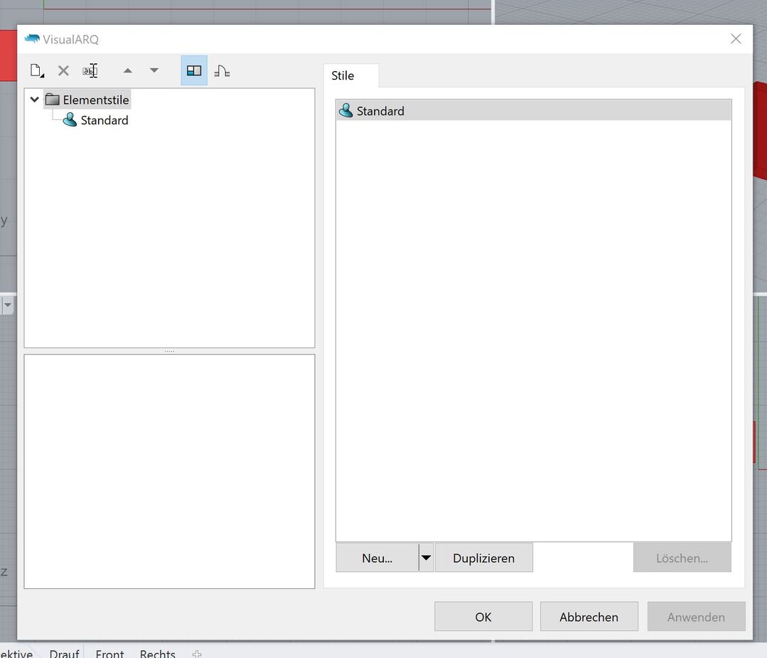

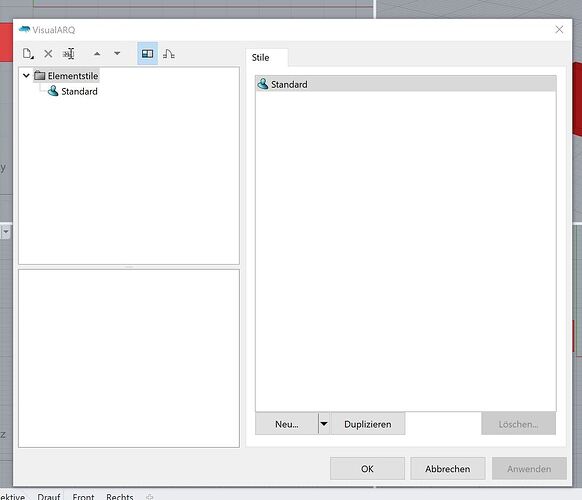

Hi, many thanks for the quick response.
I want to create a Grasshopper definition
what i can use inside a Visualarq Element
with which I can change the IFC tag without baking the object out of grasshopper
I would like to use the Visualarq element for different types (heating, ventilation, etc.) and would not always have to change the IFC tag manually (after placing the model), but rather that it is controlled by the definition file. (especially since some IFC tags are still missing “ifcBoiler, ifcPump etc.”)
