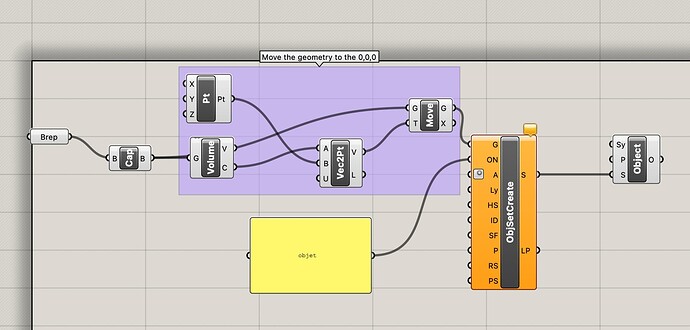

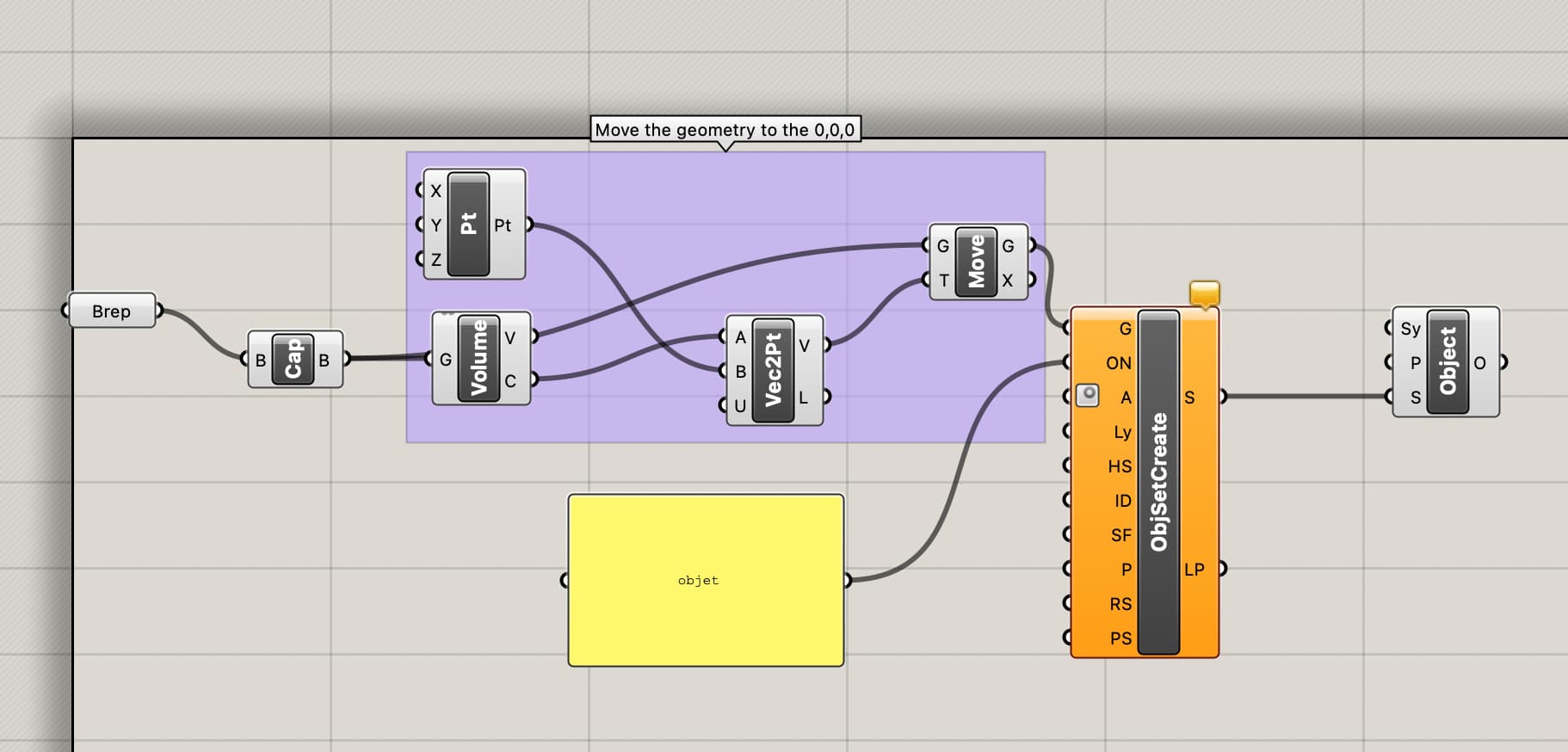

Hello Luca,
I didn’t see what’s wrong, I didn’t see the ghost box either. But one thing is essential: before creating your object, move its geometry to the origin (0,0,0). It will be the insertion point of it in ArchiCAD.
Thanks very much Felipe. I got it to work with this method.

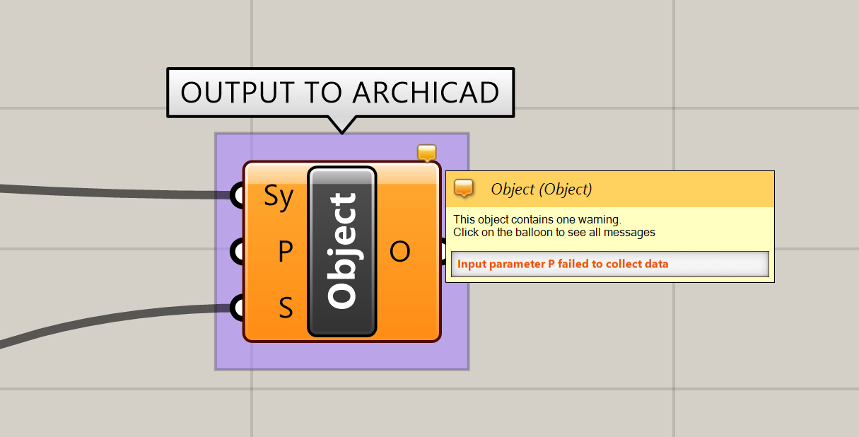

However, just to clarify, did you leave the P value (the anchor point) as unspecified, in the Object component? Are you not getting the warning?
Thanks Felipe, the question was if in your definition you set the point input or not, to avoid getting the weird ghost box and have the correct result in Archicad.
