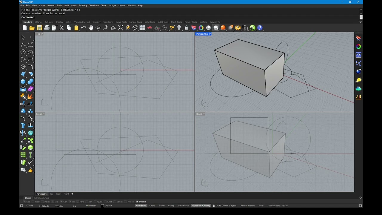

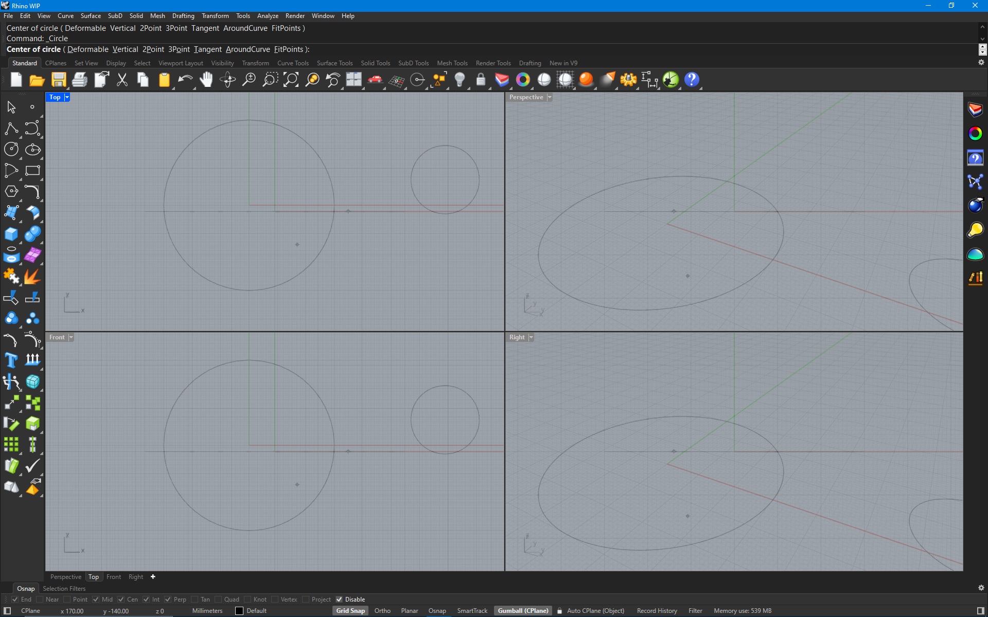

i seem to be getting some strange graphical artifacts when i switch to this on wip

graphics update did not solve this issue still persist its only when i am in 4 view mode

I’m having trouble understanding what the glitch is that you are seeing. Is the grid drawing incorrectly?

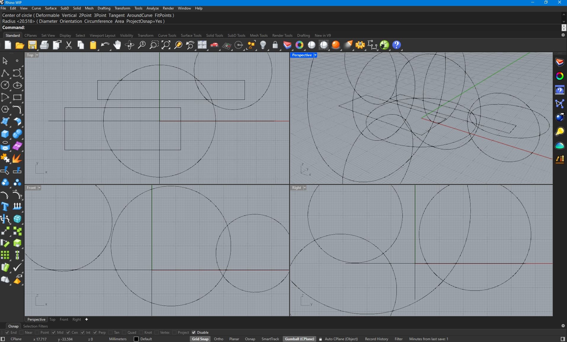

Curves are faded and looks like there is an extra grid showing is the image not clear?

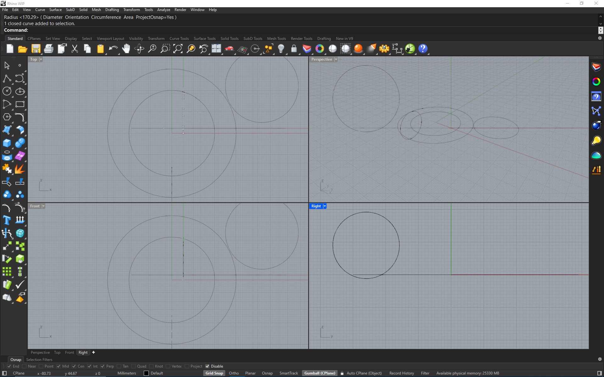

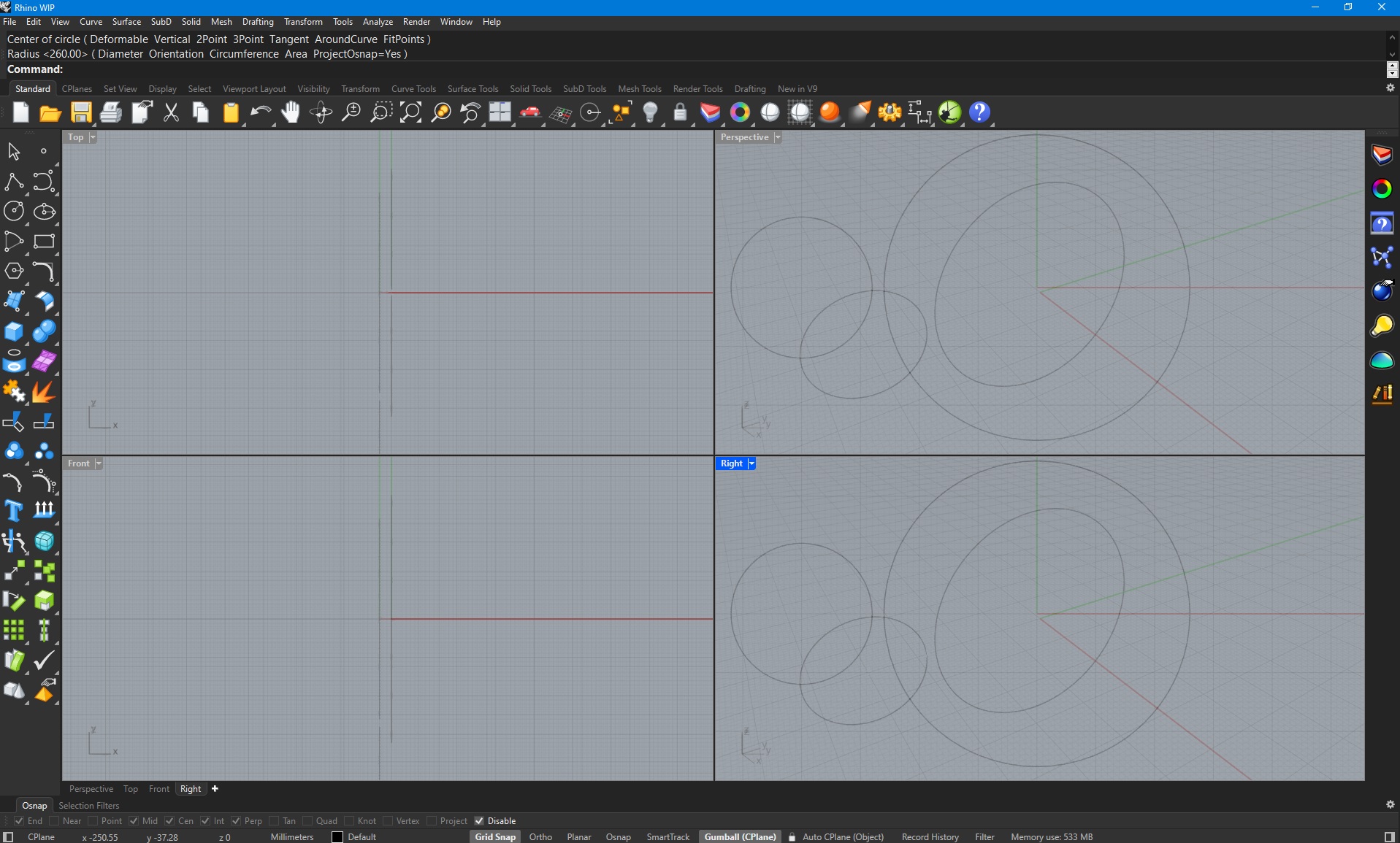

Only when I am in 4 view when I interact or create those circles it stays like this on all views
This is wip 9 default with dark mode only nothing more than that

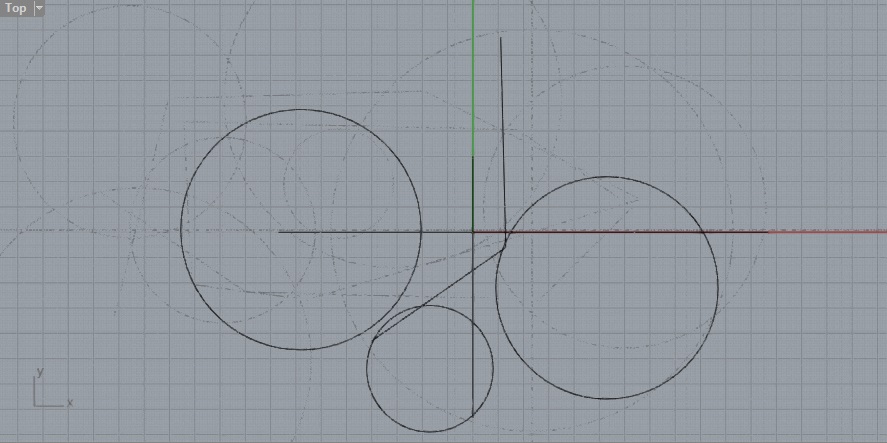

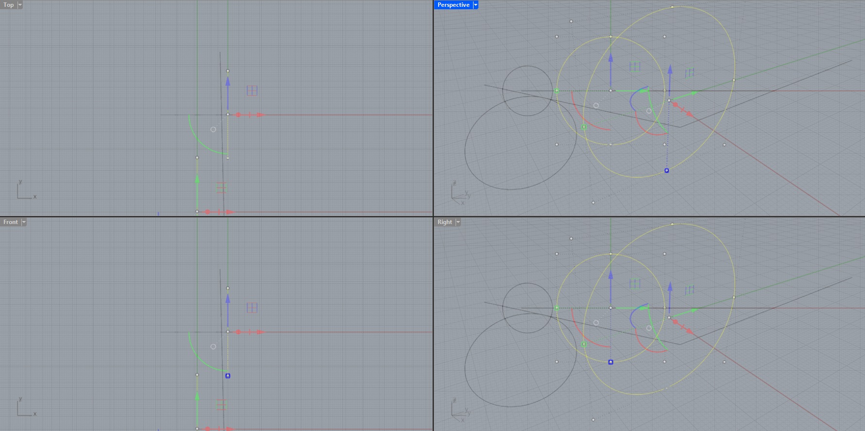

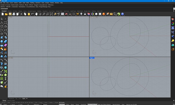

just tried it again looks to me its 2 viewports intersecting as soon as i start a command
very trippy
Does this happen if you turn off antialiasing?
antialias off fixes it but does not look nice

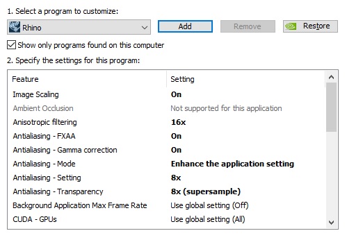

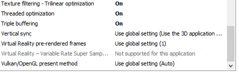

Also, have you made any tweaks to the NVidia Control Panel? If so, which ones, and what settings are used?

Nvidia settings it seems to have taken what i have on rhinoceros 8:
i just did a restore on the nvidia settings to default and it seems to have gone away and is working normal there has to be something on there causing this
Thanks for letting us know and good to hear this is working now.
