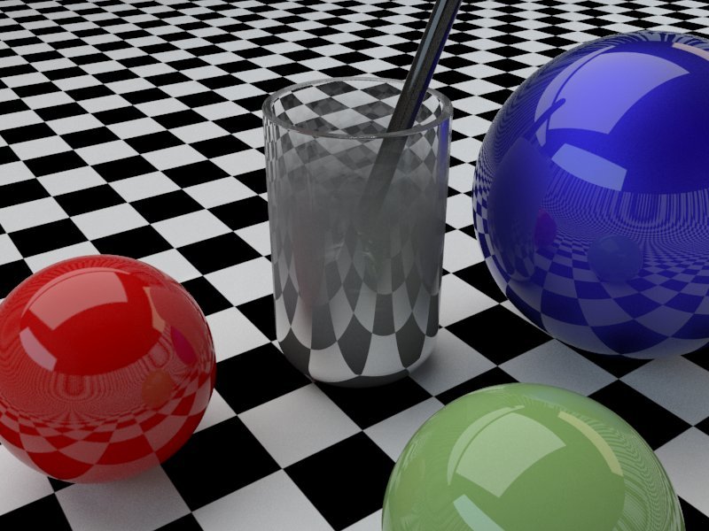

I’m pretty sure this covers it. http://www.vray.com/vray_for_rhino/manual/transparency_mapping.shtml#Another_method_for_creating_the_same_result

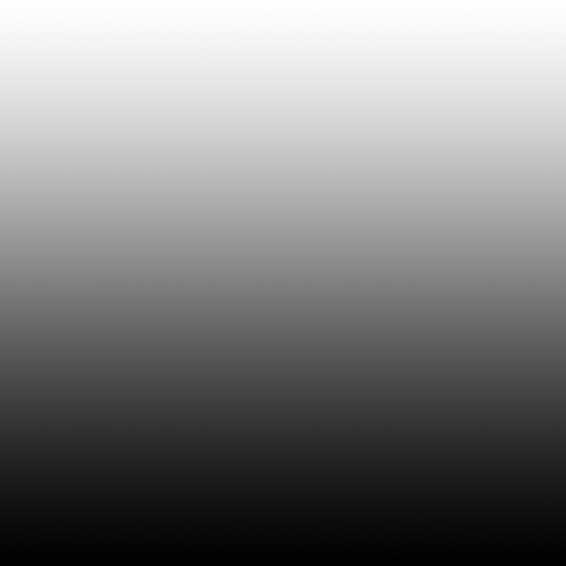

-top layer diffuse with a gradient and “Use the…as transparancy” box ticked
-base layer VRayBRDF glass

Sorry for the confusion. What I want (refering to the manual you provided, example 4) is to exchange the pink/red color to a reflective (chrome) “color”.
I would build this with a custom standard vray material. The BRDF materials are a total pain. Start with 2 diffuse layers and add reflection and refraction layers as per the manual.
As for metallic materials they are generally just grades of black and white. So just replace the pink and yellow diffuse colors with light and dark greys.

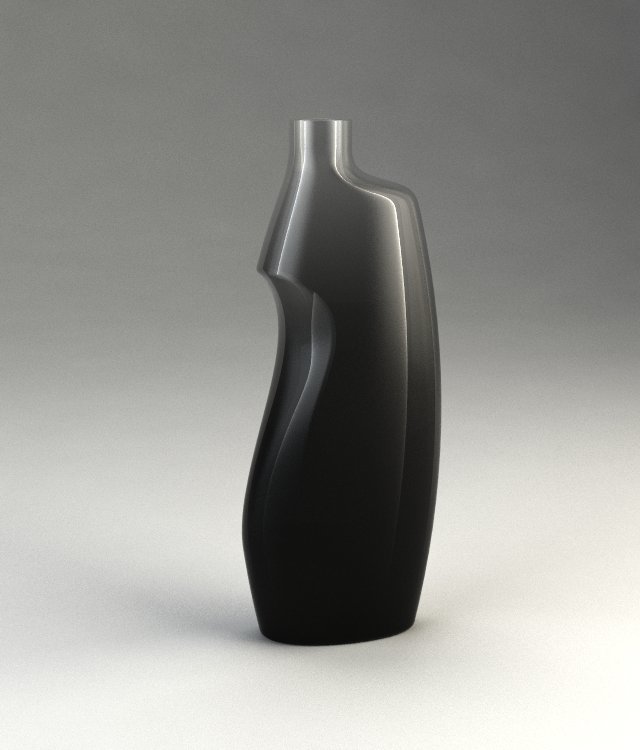

Well I give up. I thought this would be an easy and interesting challenge. After an embarrassing amount time spent fiddling with settings. This is the best I could come up with. I think you should hit up the chaos group forum and get some real experts to weigh in.

That is an almost perfect result Marc! Thanx.
I will fiddle some more when time permits
Thanx Marc!
