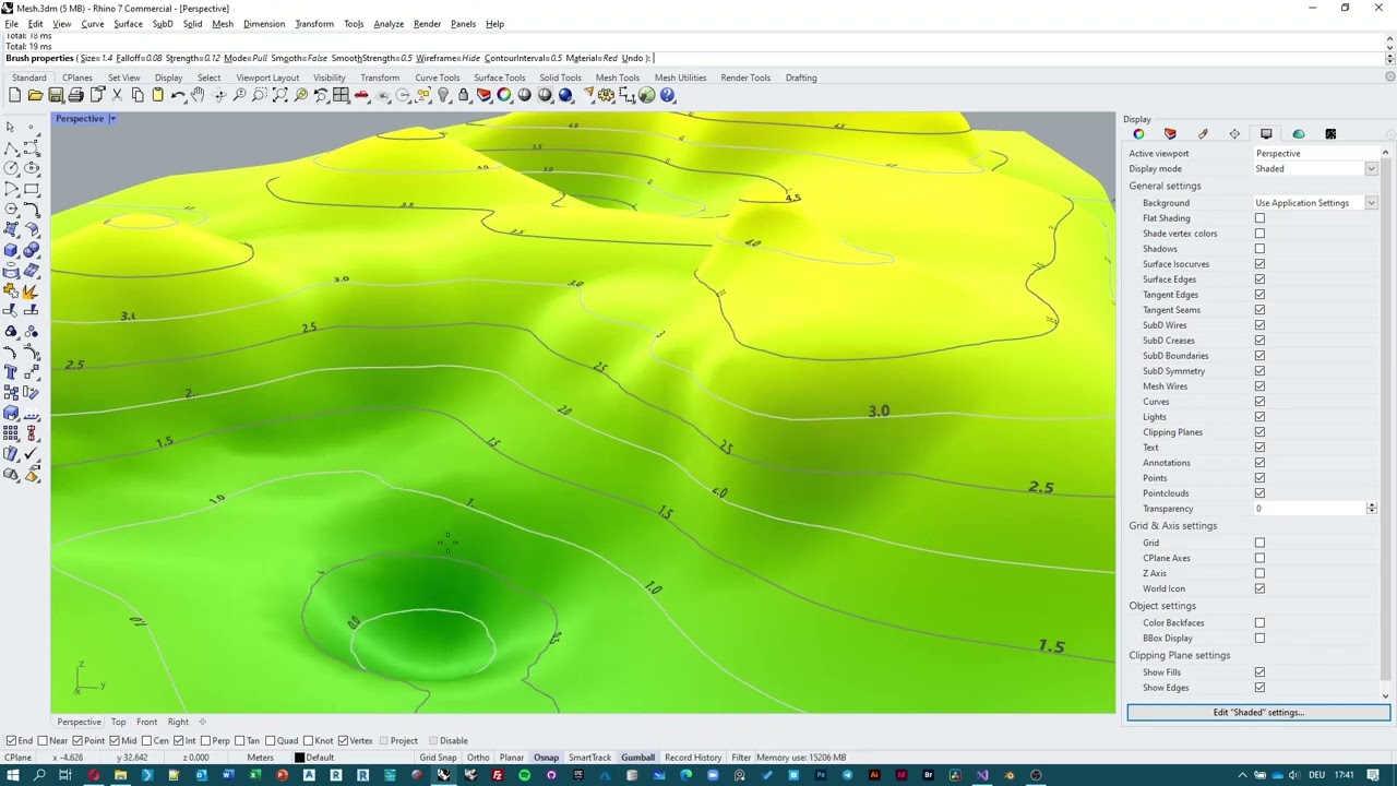

I’m working on a terrain modelling plugin for Rhino. One crucial functionality is to have interactive contour display. It’s been a fun challenge to solve but I’ve got most of it figured out in GLSL.
Now, I’d like to create elevation labels for these contour lines. The actual intersections are computed in the geometry shader but I can’t figure out a way of accessing the point buffer generated in this shading step. Any ideas @stevebaer @kitjmv @jho ?
I’m working directly from a C# Rhino plugin and the attached GHGL file is only used for reference and ease of prototyping GLSL_contours.gh (462.6 KB)
A screenshot and short clip of it in action:
Well, I’ve figured it out.
Transform feedback will capture the outputs of a geometry shader. Then it’s a matter of filtering the resulting geometry and placing an elevation marker where we need it:

That looks amazing. I’m assuming you must have done something beyond what GhGL currently provides
Thanks @stevebaer!
I forked the GHGL code, and adopted it to run directly from a Rhino C# plugin. For the above approach to work, I had to extend the existing GHGL functionality to include the following OpenGL calls:
glBufferSubdata
glBeginTransformFeedback and glEndTransformFeedback
glTransformFeedbackVaryings
glBindBufferBase
glGetBufferSubData
If you want, I can submit these as a PR to the GHGL repo.
Now I can use GHGL as a poor-man’s compute shader and pipe the results back to a buffer accessible to the CPU logic. At least until Rhino transitions to .NET 6 and we’ll be able to easily use proper hardware acceleration with https://www.ilgpu.net
