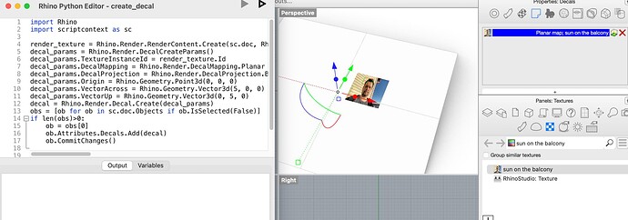

Your code is very close to how I would write it:
https://jesterking.github.io/rhipy/create_decal.html
I do notice buggy behavior with adding decals once you’ve already added one to an object. I have logged RH-67878 Attempts to add more decals after first fail to track that.

I used https://developer.rhino3d.com/api/RhinoCommon/html/M_Rhino_Render_RenderContent_Create.htm, which is available from Rhino 7.9 onward. If you need older Rhino then https://developer.rhino3d.com/api/RhinoCommon/html/M_Rhino_Render_RenderContent_Create_5.htm probably works. I think you should pass None
of https://developer.rhino3d.com/api/RhinoCommon/html/T_Rhino_Render_RenderContent_ShowContentChooserFlags.htm as the second parameter.
Did you read the explanation on https://jesterking.github.io/rhipy/create_decal.html of how this works to create the texture?
Yes, it is basically a copy of the code i posted but it does neither use an image file (from disk), nor does it create any entries in the Decals or Textures panel. So i wonder how someone would use this example code to apply a decal programmatically ? (I do not want to pop up a dialog to choose a file). What i am trying is to add and probably later edit existing decals of on object. This includes swapping decal images and probably changing their placement too.

You can create the bitmap texture like I do in https://jesterking.github.io/rhipy/create_pbr_material_with_textures.html
lines 9-10 in the final script
No need to simulate the texture nor material, just attach it to the document like you do in your script.
Note that in my script version you need to have an object selected for the decal to be even added, and over the world origin for the decal to show once added.
