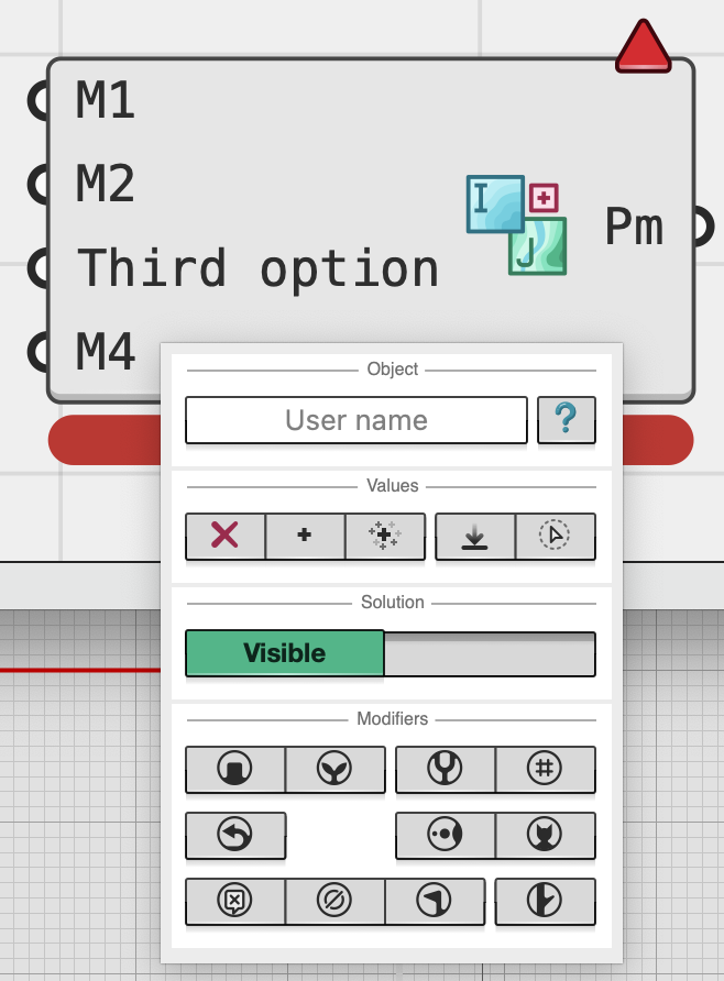

Okay, seems to work. If the component now has smarts to assign dynamic names to parameters it just assigns those to a FallbackName. The user gets to specify the UserName, if the UserName is not set, the FallbackName is used in the UI instead.
So in this example, all the “M{i}” names come from the fallback field and do not appear in the pop-over name textbox.
