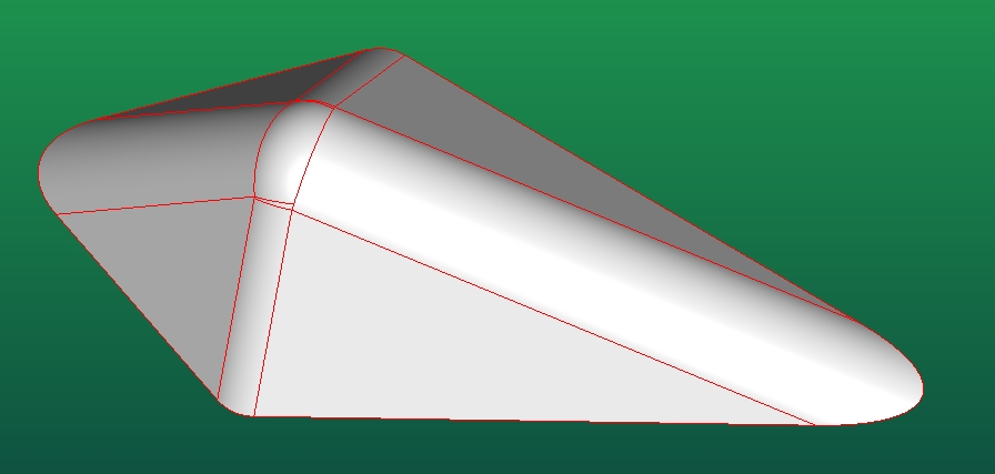

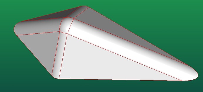

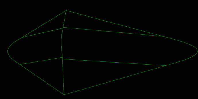

You’ve got a pretty nasty problem with that shape. The problem happens after your first fillet which looks like it works fine. Actually it does, but it makes a real problem for the second fillet. I don’t see an obvious way to get around this.
Here are the edges if your original shape:
And here they are after your first fillet:
See the problem? Note that the single edge down the center has been replaced by 2 - 1 on either side of the fillet. Except it isn’t really 2, it’s 4, and that’s because the perpendicular edge has been split into 5 separate edges - 3 long ones and 2 very short ones. You have to take the output from the first fillet operation and use that as the base shape for any subsequent ones because the Fillet component can change the way the remaining edges are defined.
The same thing happens if you fillet the other 2 edges leading up to the peak. So I don’t see how you can get around this - unless you convert your base Brep to a mesh and do some sort of mesh smoothing. But this will (I think) round off all the edges, not just the 4 sloping ones.
I made a mess of your file by adding a bunch of Edge and CherryPicker components which you can play with to see the problem for yourself. I’ve actually run into this same problem a few times myself. Since I don’t like meshes I just gave up when I found one of the pre-filleted edges split into multiple parts. Someone else might know of a clever way to resolve this without meshing - if so I’d like to see it.

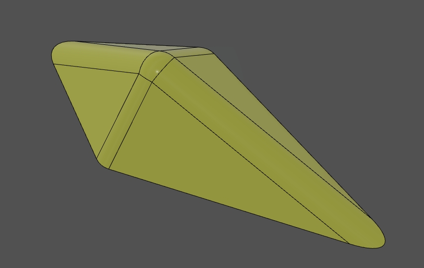

Creo using same fillet for all edges:
Using different sizes for x-y curves:
Fusion360 yields identical results:
